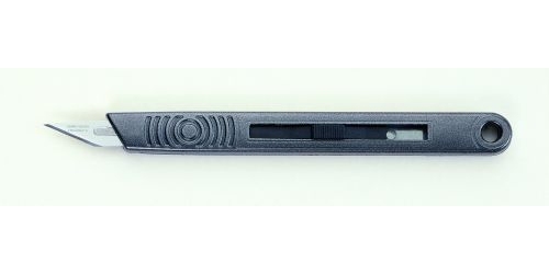

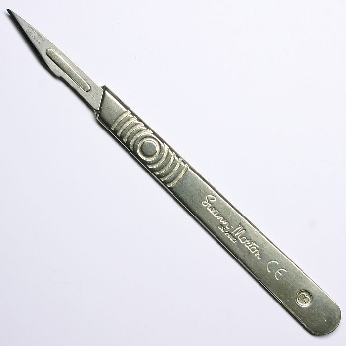

    I mostly use an Olfa knife too these days, but with the 30 degree blades as shown in this attachment. find the other blades pretty clumsy to use…
    I also use Swann Mortan scalpel retractable and rigid, as shown.
    that aside, i thought windows are removed from vehicles for tinting and any than cannot the film is applied below the rubber seal?
    just my take on it, may not be correct as i do not get involved in vehicle tinting but have done allot of office windows using bomb proof films.

    With vehicle window tints, I usually just roll it wet onto the window and cut around it leaving some excess, then move it onto a wet board and cut the lines straight with a swan morton blade pictured above with a metal rule.
