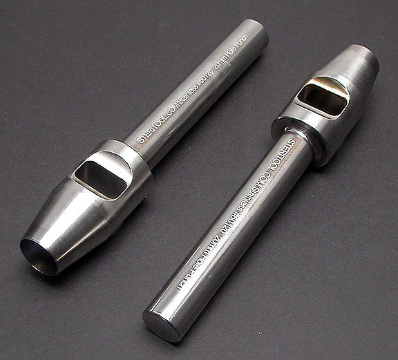

    I have used a hole punch in the past. A simple twist and cuts a perfect circle

    hole punches will cut out a circle around a rivet and they do come in different sizes. I have one and arguably they do work… but there is no way I would be comfortable with my staff using them on a painted vehicle. too much pressure or a heavy-handed twist and your cutting into the paint-work. granted, if it is GRP sides then its a much harder surface and won’t be damaged just as easy. but I tend to find that a heavily rivet peppered truck side is normally a painted aluminium or similar.

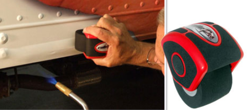

    around 13 years ago a company brought out the RollePro vinyl over rivets applicator, combined with pin pricking the hole on top of the rivet, if there is one. This was posted back then, here on uksignboards.com. I purchased one via Craig Brown of Signs Express back then i still have it today. even though i do not use it for rivets, but textured wall surfaces and the like. Anyway, i never could perfect the technique of using one of these when wrapping 44ft artic trucks, and i found it much faster to forget about having to leave air channels to expel the air from the rivets and concentrate more on my vinyl panel alignment.
    The following video by Arlon gives a nice tutorial on how to apply vinyl using a similar tool to the rollepro.
