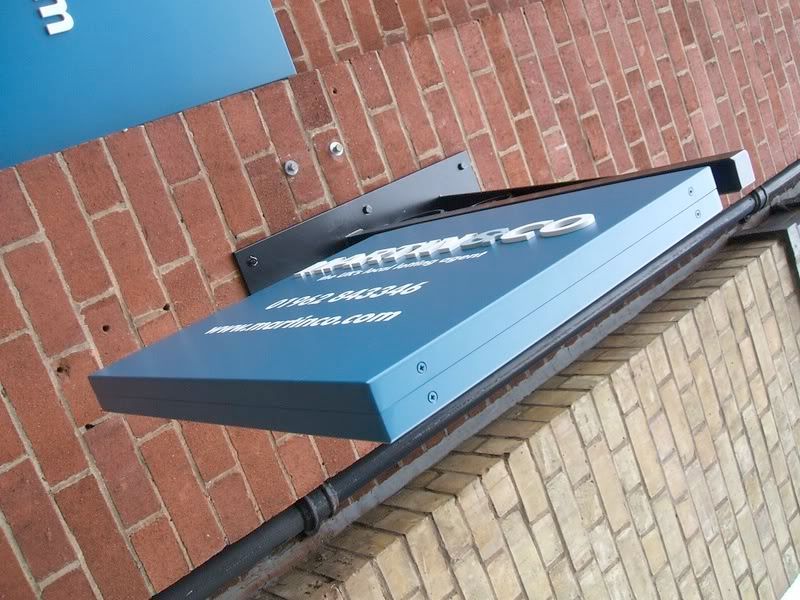

    Hi All
    Customer wants a new board for his swing sign but he wants something very chunky about 40 – 50mm thick and it needs to be black (Matt) and not overly heavy for obvious reasons.
    Any ideas if there is something existing I could use or would I have to build it up?
    And what material would you recommend?
    He wants it as simple as possible (no fancy edges or anything)
    Warren

    12 October 2007 at 15:03
    saw this today and thought a good neat way and clean and simple edges.
    I would say its 2 aluminium trays back to back with wooden panels inside to attach to and drive hooks in the top?
    Anybody done one of these before?
