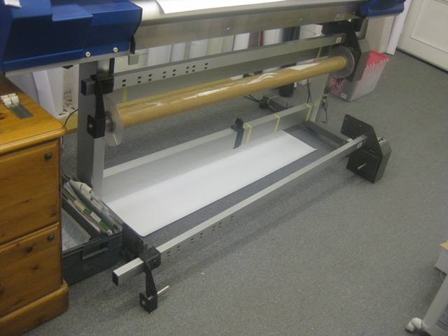

well heres the update
the unit never arrived courier didnt find me they lost it so
went elswhere and found a genuine roland one
through a frendly engineer who was in the right place at the right time
😀absolutely mint it sitshalfway to floor and only takes up a few inches at a time so the roll is always loose happy days
in fact i have nearly a full unit spare if anyone interested it need power supply £50 from maplins and end reels for basic set up and magic eye for automaticderek
