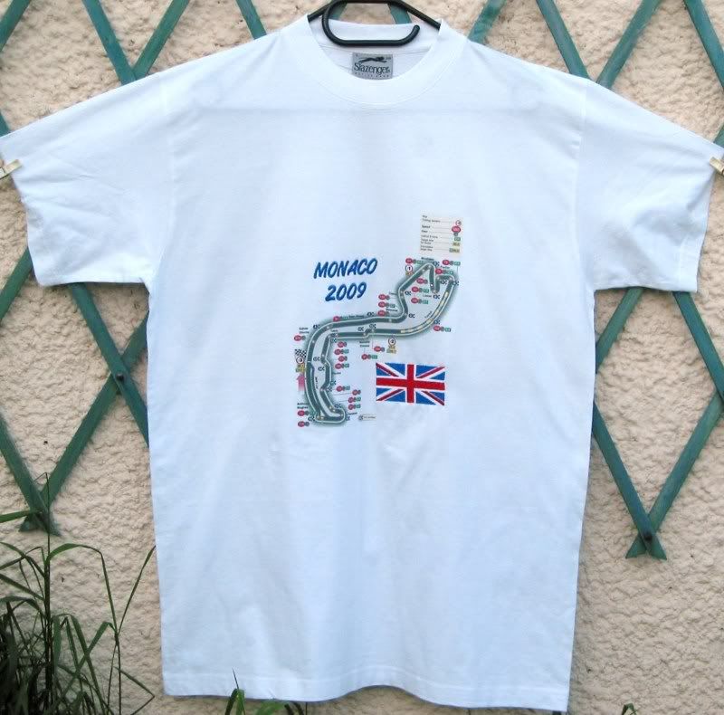

    We did some EZtrans printed shirts this weekend.
    The colours came out very well as did the detail. So far, impressed.
    My concerns are:
    1. 190deg for 30 secs is quite a long time on a white shirt! There was a very slight hint of scorching but this was being hyper-critical
    2. Where there’s no image (in other words, white space), it feels a little tacky which soon dries away but, still has a starchy feel to it. This is something I’ve noticed with papers from TMT (The Magic Touch) and if washed with coloured items, if the coloured item run, this tacky/starchy area might pick it up – it did with TTC 3.1.
    3. The washing instructions say – wash cold. I don’t think customers will remember this.

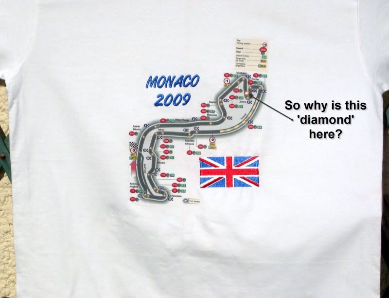

    Here’s one I did earlier using EZtrans 101, embroidery & one rhinestone crystal:
    Close up
    And one I plan doing later 🙂 (I must edit that eye – it’s rather meaningful)
  • Paul S Martin
    26 May 2009 at 22:24
    Hi John
    Thats the speed camera’s 😀 Great Job M8
    Paul

    Thought you would have got it Paul!! Sorry, not a speed camera 🙄
  • Paul S Martin
    26 May 2009 at 23:04
    "Doh" 😛
