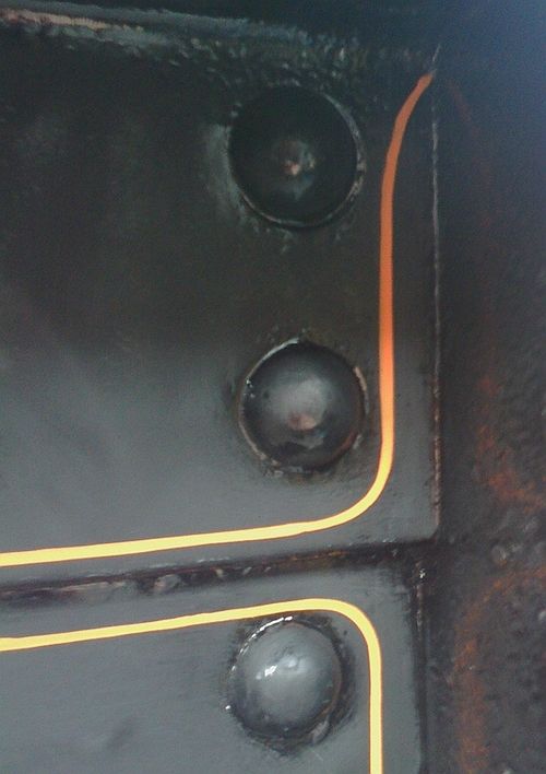

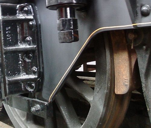

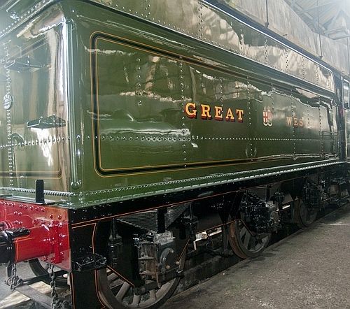

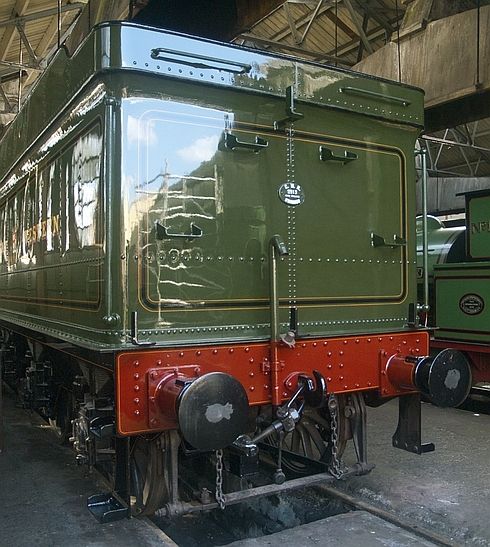

    Ended up venturing a few quid on a Mack 000. Totally different experience to a trad coachliner, but 300-odd feet later I think it’s safe to say I’m a convert 😀
    I trimmed about 2mm off the bottom & that helped constrain it; might take another 1mm off though.
    Now tempted to get a 00 or 0 & see how that fares with the 3/8" stuff.
    Pete.

    Lovely traditional work there Pete! Now you’re convert, what would you say was the main feature that changed your mind?

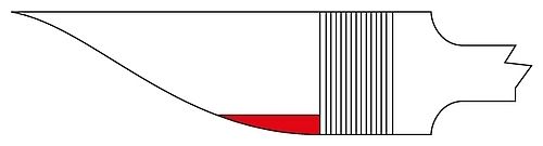

    5 October 2015 at 12:47
    Yes, I cut a bit off the ‘belly’ like this:—
    The red area was removed with a nick of a scalpel blade against the stock & seems to have had the desired effect.
    Just pulled the trigger on a 0 from Jackson’s/Handover’s Amazon shop for a tad over £12, so we shall see what occurs.
