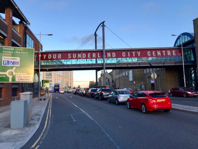

  • Chris Tennant
    2 September 2019 at 22:06
    Watch for the sun if really hot and your inside. Gave myself heat stroke once doing a Jamaican restaurant once. Had cancel rest of days jobs. Was only at window for half hour. It was rough.[/quote]
    Wait what, half an hour and you had to cancel work?
    I did this on my own in 2 days. Windows were 1600 deep and all spot lettering was put on first then floated in red, 60ish windows in all.
    Was middle of summer, around 25 degrees.
