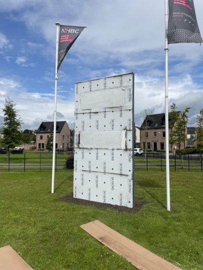

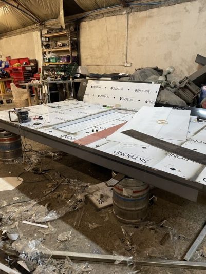

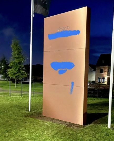

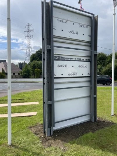

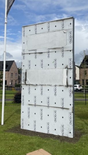

    Looking for a rough estimate for pricing this job to see how you price this sign, just rough figures out of interest, as it took longer than I thought and had more components than I imagined.
    The Steel above the ground is bolted to 3ft x 3ft x 5ft steel and 2 m2 of concrete.
    I supplied the steel, but I didn’t concrete it into the ground as builders wanted to do that, so the price for manufacturing signs 3.6m tall, 2m wide
    Steel Structure:
    1 sheet of 4mx2m Dibond
    6 sheets of copper dibond 10 x 5ft
    2 trays recessed with perspex frosting
    10metres of LED lighting, Bluetooth with RGBcwww,
    Welding done in-house, CNC dibond in-house.
    Materials alone are at £2560 and counting.
    80 hours of manufacturing.
    2hrs fitting
