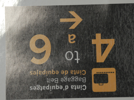

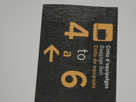

    Hi andy,
    here are some photos of whats going on! please tell me your results arent as bad!!
    I could go on adding photos, but they are all rubbish!!
    any views please?? Is it dodgy cling??
    thanks
    Dan

    Dan
    I cant’ help you on solving your problem but I have just printed some of the metamark self cling and haven’t had any problems at all.
    Just used a monomeric vinyl profile.
    Gary
  • Andrew Blackett
    19 March 2009 at 21:25
    Yeah thats rubbish by the looks of things Dan!!
    If you want to post the original file I’ll do a test print on the molko penstick and you can see the difference.
    Europoint sell it over here.
    Andy
  • Richard Urquhart
    19 March 2009 at 21:32
    Not that I can give any help, but I printed 600 a3 self cling the other week, print was fantastic the only prob I had was contour cur ran off on a long print. I guess the self cling moved on liner, can you try another material?
    printed in versa works with md3 profile on high speed head speed 1000
  • Dan Osterbery
    20 March 2009 at 07:54
    thanks guys! I have posted the file! If it works ok for you do you think we have some dodgy cling?? I have printed onto clear and am testing that now!!
    cheers
    Dan
  • Dan Osterbery
    20 March 2009 at 10:20
    Hi guys,
    dont worry about printing it! I phoned roland got a profile for metamark cling and its was still awful, so I came to the conclusion it was the cling, cleaned the surface with alcohol (the evaporating kind, not the good stuff!!) and it has printed perfectly!! Ahhh frustrating but at least were working!! Thanks so much for you time!!
