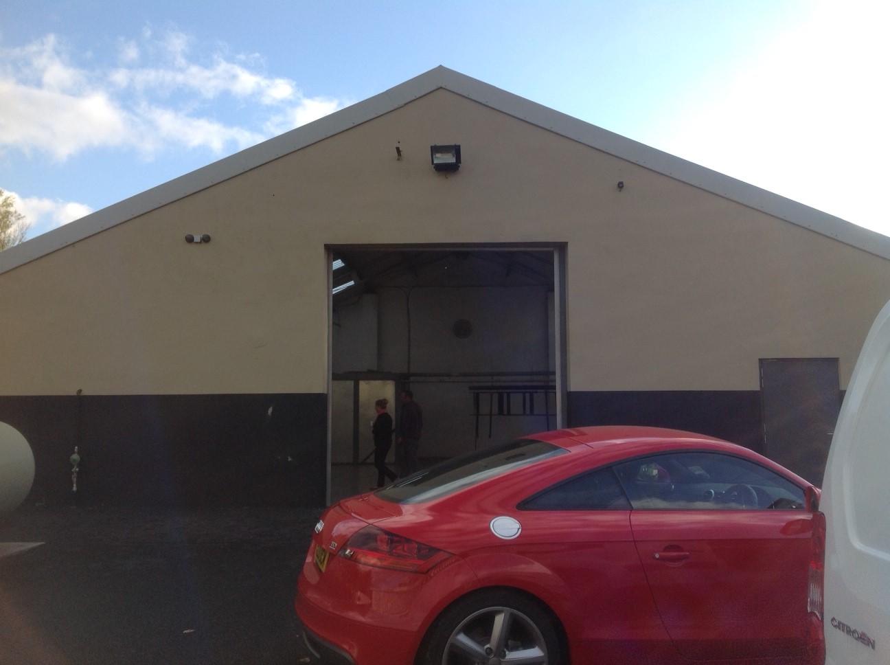

    hi all a customer has aked for the above signage
    fabrication is not a problem
    the building is painted and i am worried that the lettering will be lost in the daytime
    any recommendations
    i was thinking of mounting all the lettering on a coloured pan tray
    just not sure what colour to get the best results day /night
    any pointers apreciated

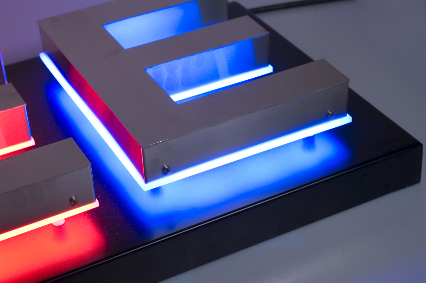

    The best halo you can achieve is if the background is a matt light colour – looking at the building this seems to be the case, although a tray painted matt white would give the optimum halo.
    Halo illuminated signage is meant to look delicate and understated rather than in your face like a face illumination but with the halo being blue rather than white I think this would stand out quite well. You could also oversize your backtrays to create a key line as well as a halo which will give it an extra punch. See picture…
    Hopefully this will help 😀
    Katie x

    Brushed rather than polished would help it stand out a bit better during the day especially in the unlikely event that the sun shone on it. :lol1: :lol1: :lol1:

    4 December 2013 at 09:43
    i like the look of that keyline effect kate, almost looks like a neon band.
    i am guessing from the picture this is a polished edge acrylic, looks a nice effect against that dark back.

  • Katie Asken
    4 December 2013 at 11:12
    quote Robert Lambie:
    No polished edges Rob, just 4mm opal polycarbonate back tray that is oversized by a few mm rather than sunken.

    4 December 2013 at 12:20
    Robert, if you polish the edges you won’t get the same effect, to get that sort of effect the edge needs to be a bit rough but obviously not to rough :lol1: :lol1:
