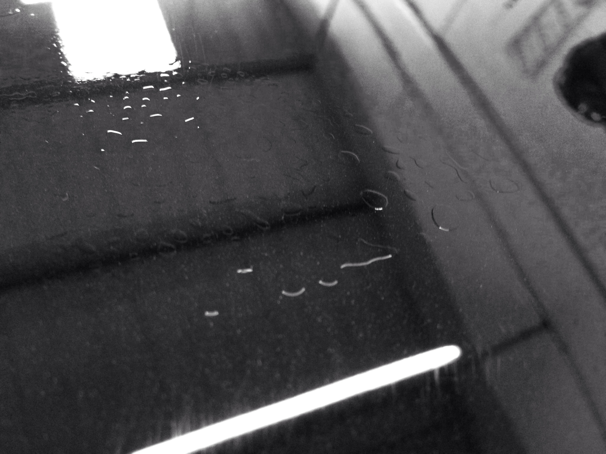

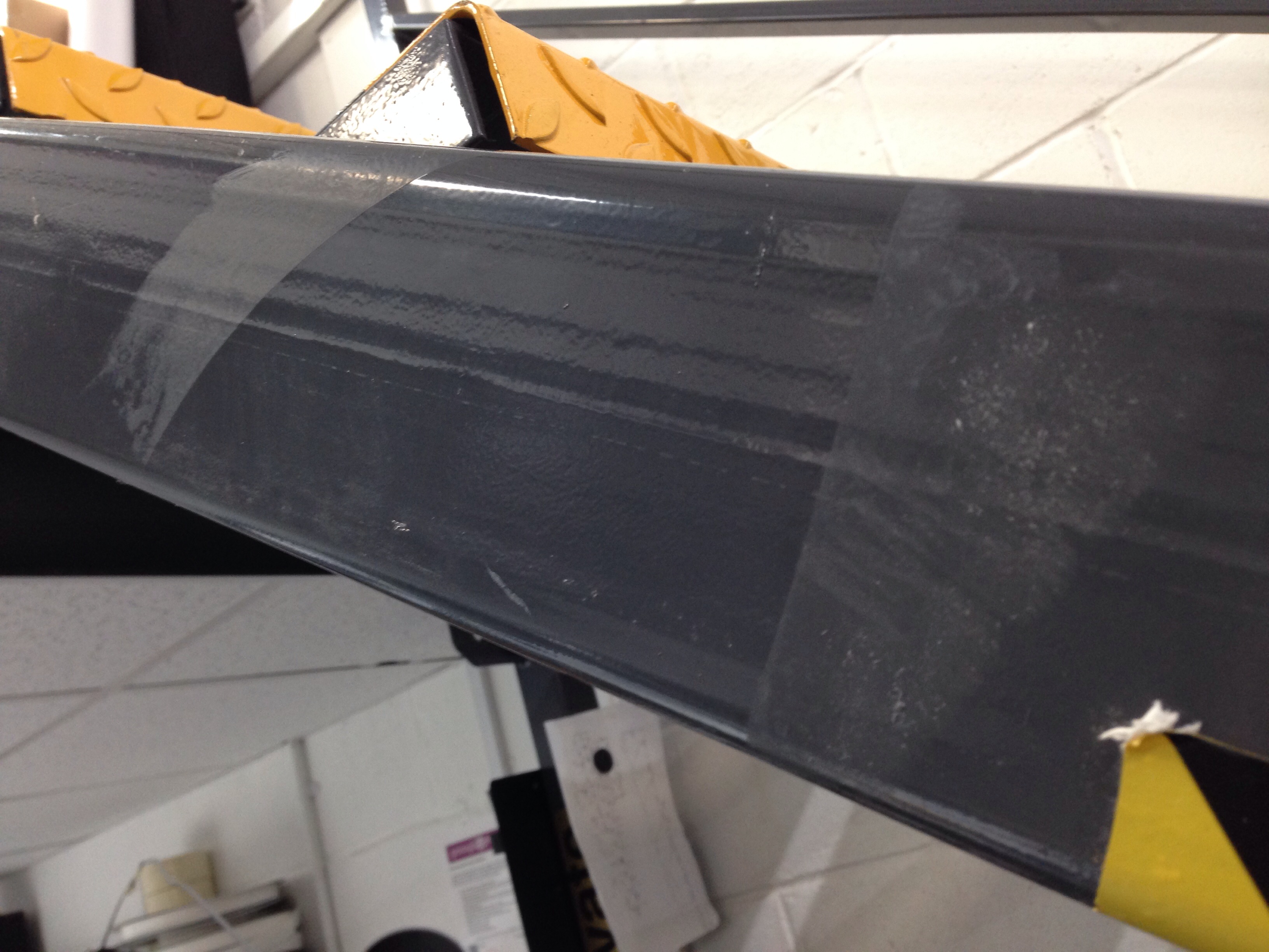

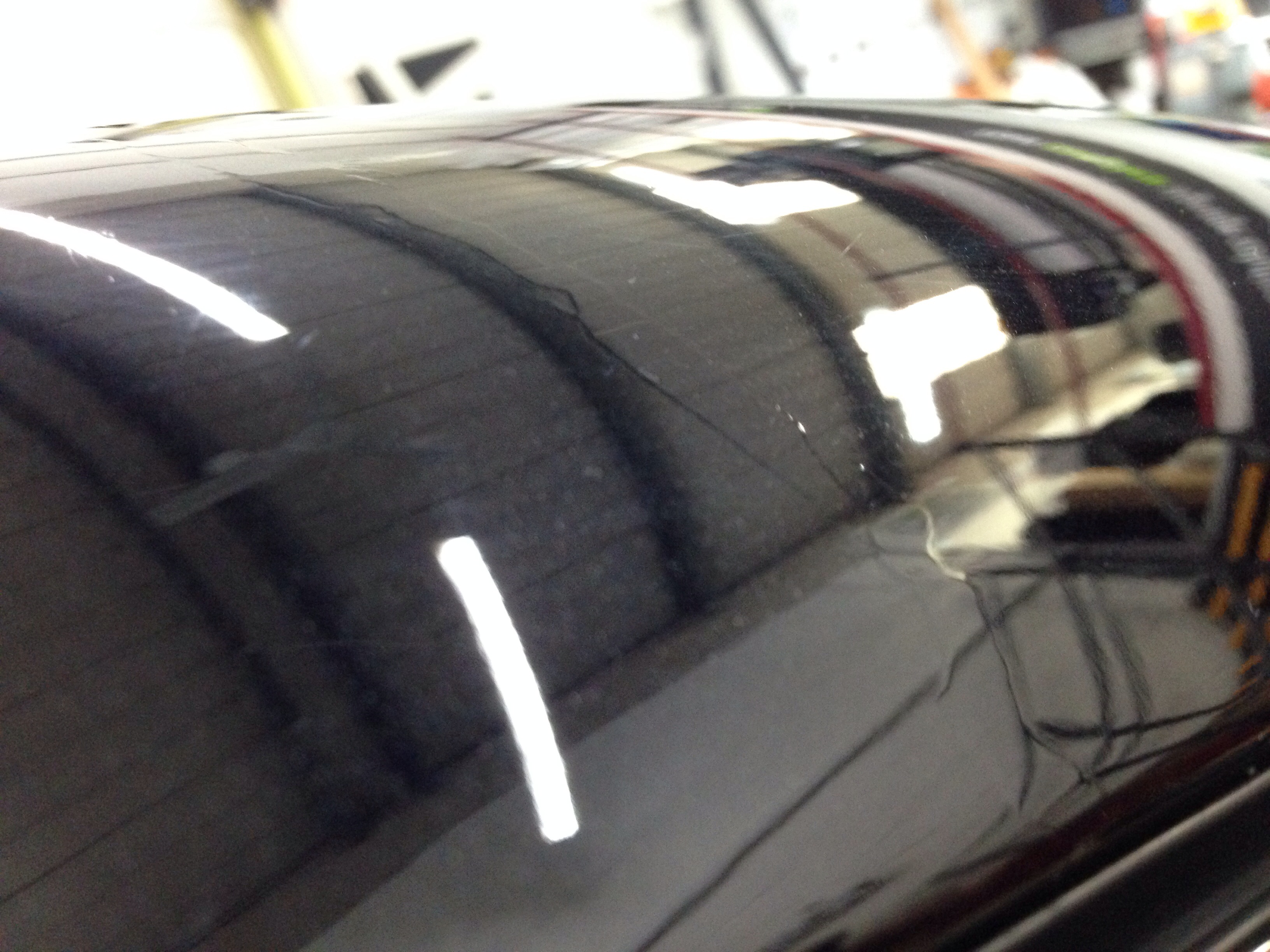

    Having seen this this post I thought I should let you know about our experience and the reason why spandex had ‘no stock’.
    We too thought this sounded like a great product, so proceeded to order some for an upcoming wrap removal.
    We used this on a Porsche cayenne, and although it seemed to come off very well we soon noticed some serious problems.
    The product started to affect the laquer of the paint, leaving what looked like bubbles and runs on the surface of the car. Panic is not the word. We also noticed that it had destroyed the Porsche badges, practically melting the letters. it also ate into the plastic of the rear lights, leaving them looking dull and scratched instead of shiny.
    Needless to say we stopped using and got straight onto spandex… They have taken this product off the shelf, Europe wide, until they have done further tests. We had a call yesterday from their call centre staff ( who obviously had no idea it was us who first reported the problem) telling us a new spec sheet was being sent out.
    I tested this on some other items, like our own van and some powder coated metal in our unit…. Same thing, the areas where lettering on our van was looked raised, and run marks on laquer. Finish was affected on powder coated metal. I was left horrified by using this product, and nowhere on any labelling or spec sheets were there any warnings about how this could affect anything – until now, a new spec sheet has been issued.
    I have attached some pics.
    Use with caution!
