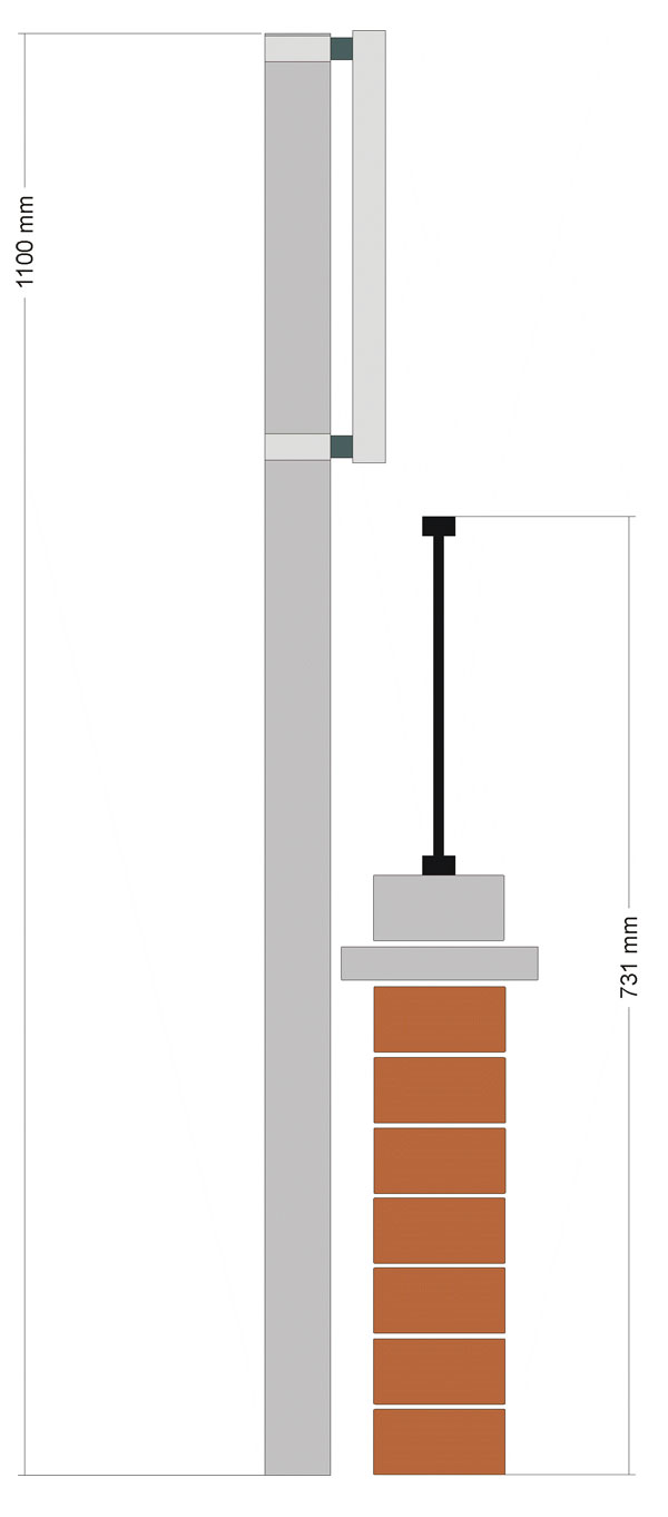

    Morning,
    Has anyone any advice on how to space the posts away
    from a wall your fixing into?,(customer didn’t want them to be fixed
    in the ground!).
    There’s an 1″ overlapping fixture on the top of the wall that I need
    to get over
    MB

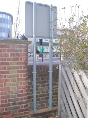

  • MarkB
    17 March 2006 at 12:15
    Thanks so much for your input,
    I’ll post pics once completed,
    Thanks again
    Mark B
