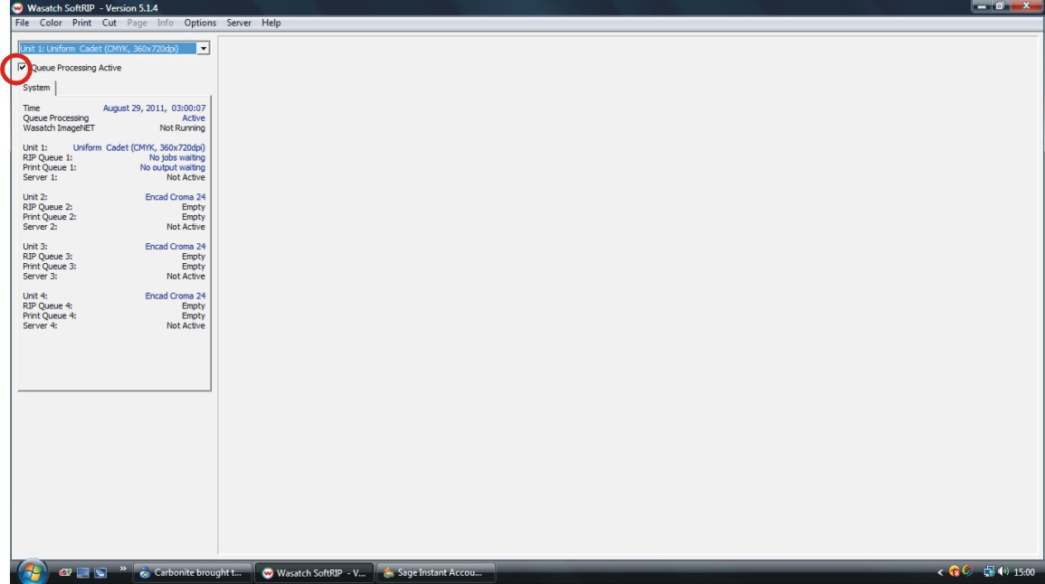

    29 August 2011 at 13:10
    Make sure you have clicked on "Queue processing Active" easy to overlook as it’s normally always checked but can end up "unchecked" after a crash and reboot

    29 August 2011 at 14:05
    Hi Dan
    My software is Troop/Wasatch which I always understood was closely related to Versaworks.
    It’s highlighted in the red circle
