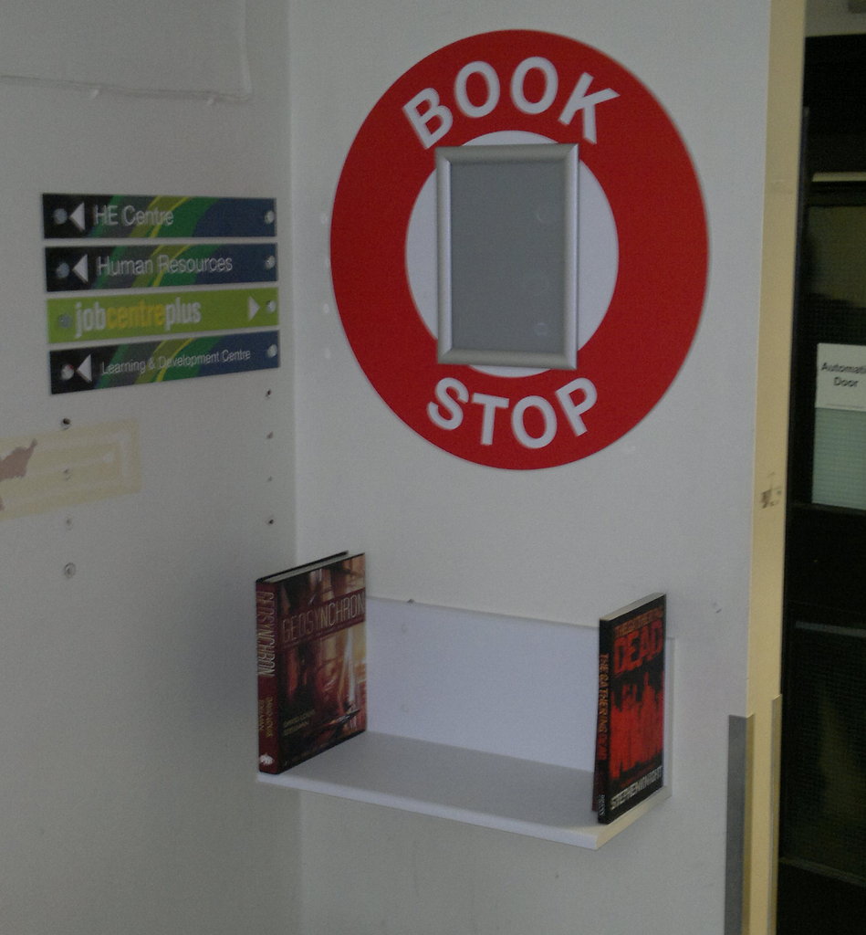

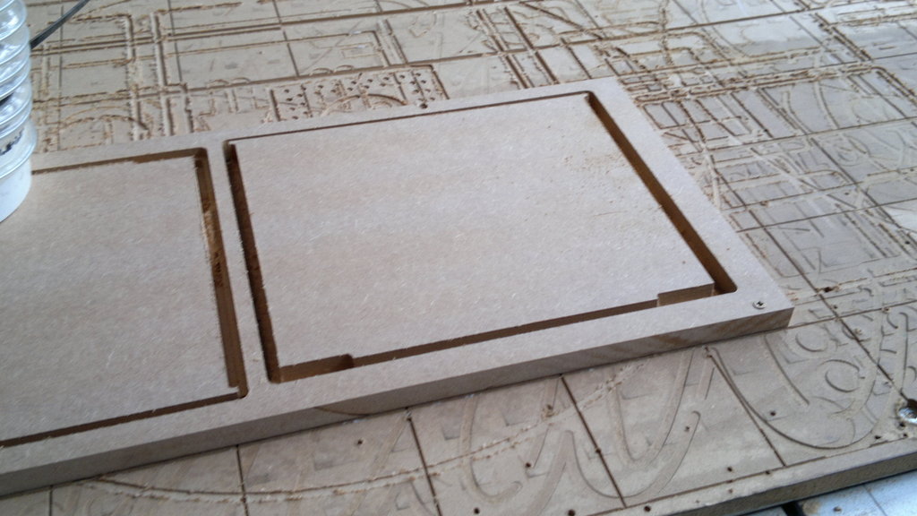

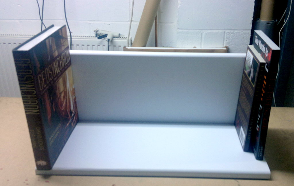

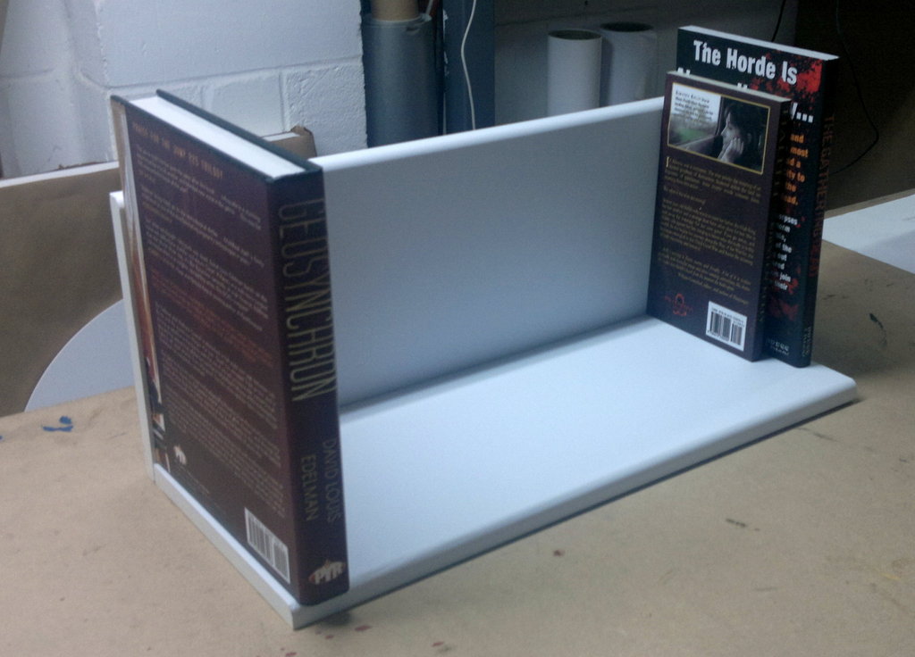

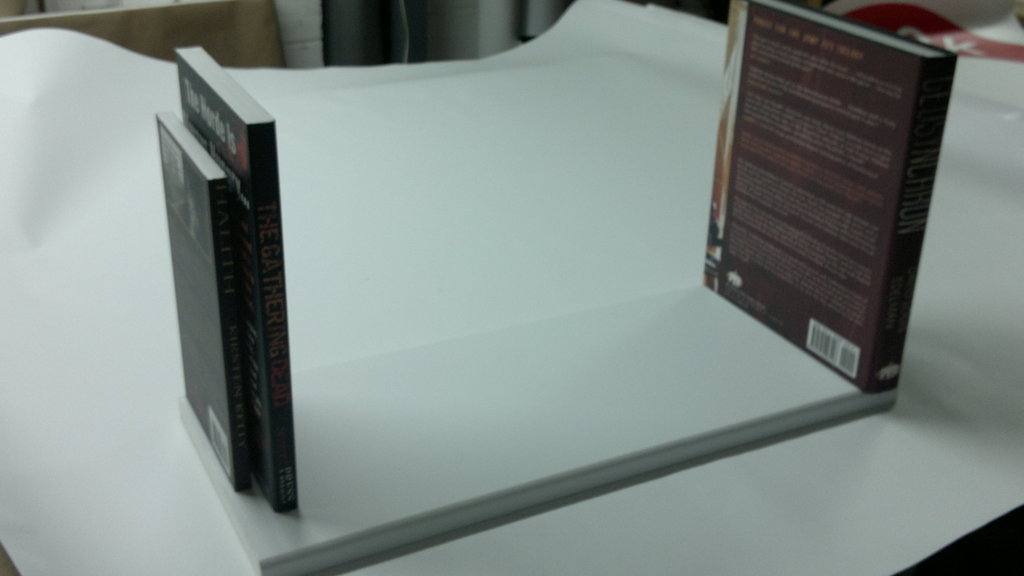

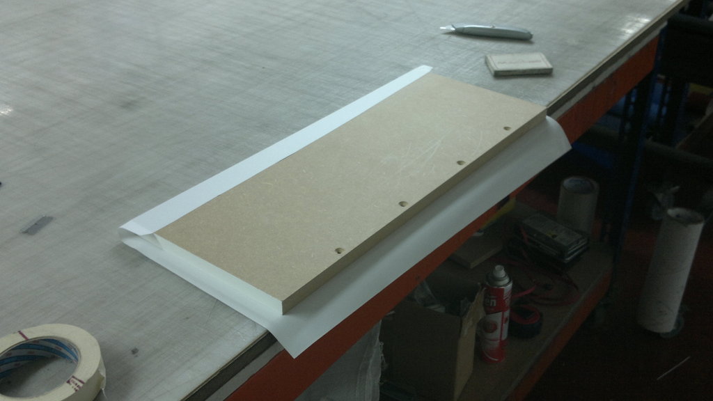

    Had a chance to be a little creative with this project, combination of CNC, print and a sheet of MDF. The shelf & rear board are MDF wrapped in high tack vinyl with anti scuff laminate. The books are again MDF vinyl wrapped & hold everything together.
    The book stop sign was made at the same time from 10mm foamex & laminated print with a central snap frame

    super cool dude, loving it.

    Nice one Kevin, like that idea.

    Im liking that Kevin, i assume there was a reasonable budget as one offs take up time?
    well done

    Cheers guys thanks for the comments, unfortunately not that well paying should have just been standard shelf but had a little time on my hands so had a play. The college loved them and they are good customers so don’t mind taking a hit on these and it shows our capabilities off especially as we work with their graphics department and all those lovely budding designers 😥

    Very nice bit of work there, i’d be proud of that.
