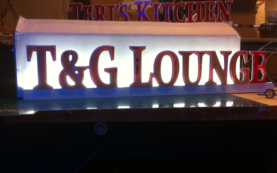

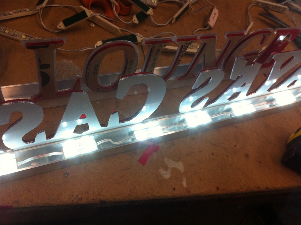

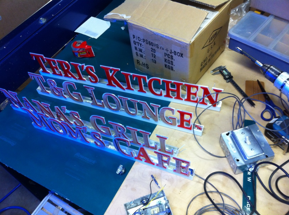

    Haven’t been here in a while but thought I’d post this fun lil project
    With left over surplus LEDs from jobs and the test comparisons, small power supplies removed from sign removals, left over .080 scrap aluminum, 3/16" red acrylic, and 1"x1"x1" alum channels I threw together these yesterday. Some quick mini Underscore channel signs as Christmas presents to family and friends. Some I can hard wire in to kitchens etc, some I made ready to plug into the wall with makeshift disconnect switches. Wish I would have had some low voltage PS wall plug in’s but for a last minute thought, this is not bad.
    Wish I would have had some low voltage PS wall plug-in units, my last 1/8" alum router bit broke and had to use a 3/16" which gave me less shape and definition for inside the letters but for a last minute thought, this is not bad.
    LEDs
    • Eurocom
    • LumiText
    • NC LED
    These suckers are bright, that’s why these LEDs perform well in our tests.
    Cheers and merry Christmas everyone!
