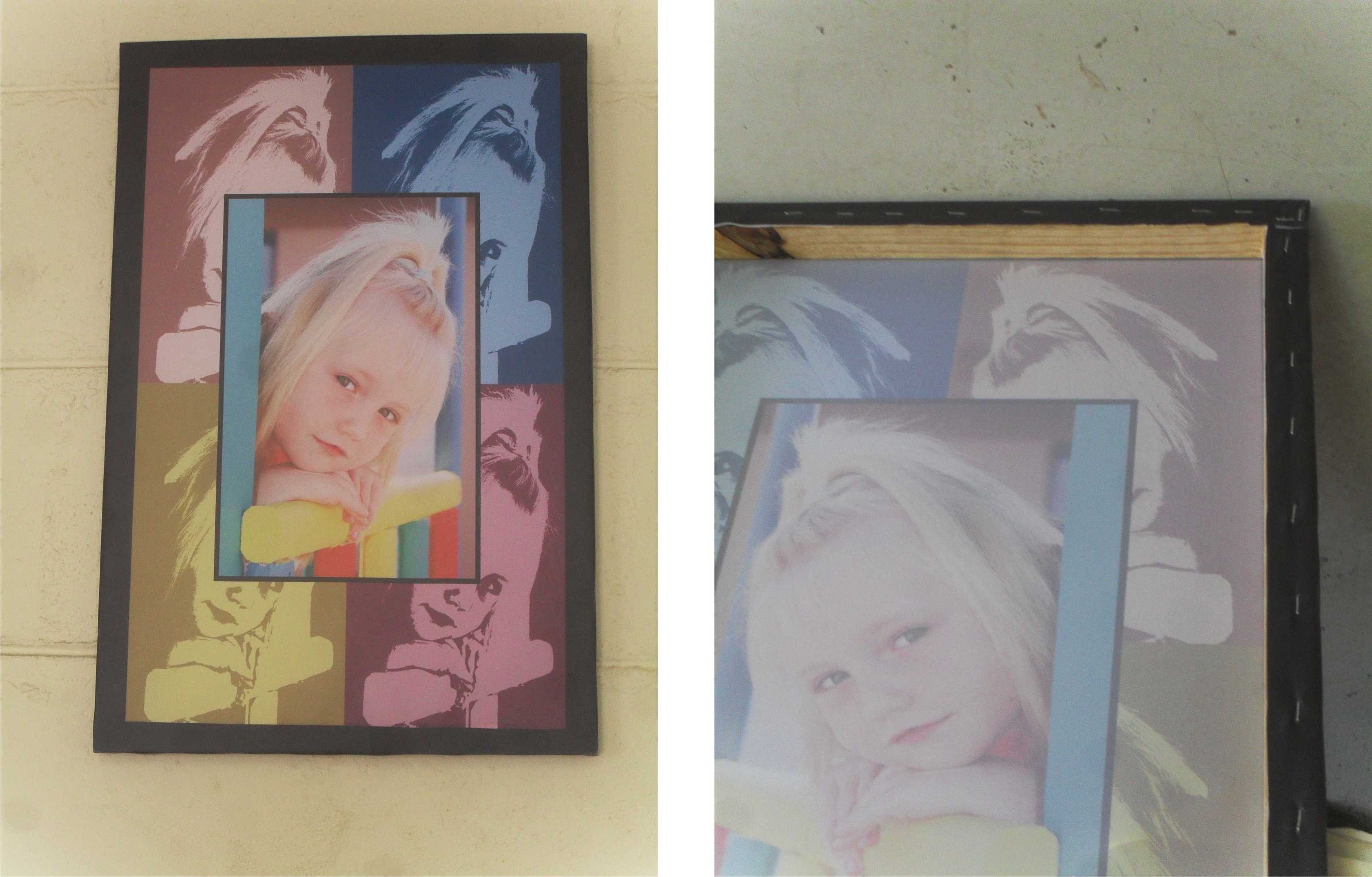

    I get a fine textured material, almost like silk (called K20), but not as glossy, that prints hugely impressive on the Rolands. Cheap as well, about the same as economy grade vinyl. I make my own frames, and stretch them inhouse as well. For the frames I buy 200 x 25mm pine, and cut them into 25 x 25 strips. A simple 45 deg mitre on the edges, a bit of glue, a few screws and a couple of staples later, the frame is ready!
    I have a few classic paintings in my den that I pirated like this! You’ll find Edvard Munch’s Scream, the Mona Lisa (every house needs some kitch!) and the Abduction of Europa by Rembrand, among others. If only they were the originals…………
    The photo shows the front and back of these frames. ( The beuty in the photo is my daughter, Carla!)

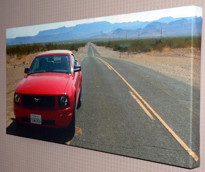

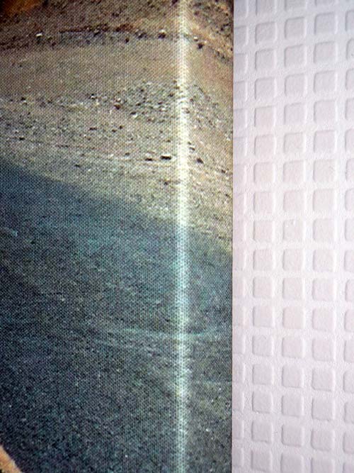

    these are my epson canvases…. colour awesome, canvas, about £2 a meter for a decent quality.

    Nice pics mo,
    I know most of my local competition are using cheap 18mm frames so may stock the thicker frames, charge that little more. But there’s a clear difference between mine and theirs. 😀
