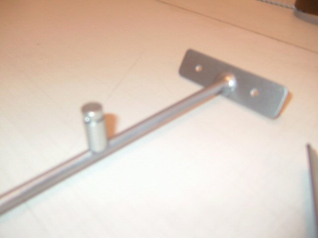

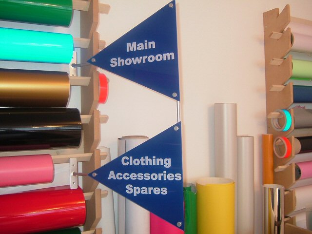

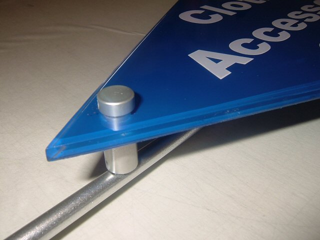

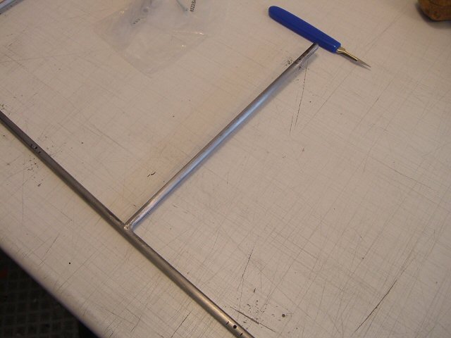

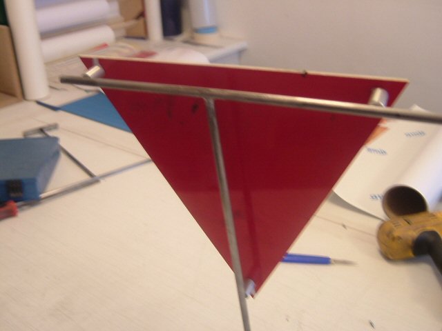

    hi all a week a go i asked for some help in mounting some acrylic panels at a 30 degree angle out from a wall i was given some help but came up with this
    i did a drawing and cut the metal and welded (like going back to car body repairs i got dirty that day )it all
    i then made a template out of fomex and set positions for all the stand offs
    i then drilled them to the tube these were then removed and sprayed all the tube
    all refitted and ready to fit on site !!!
