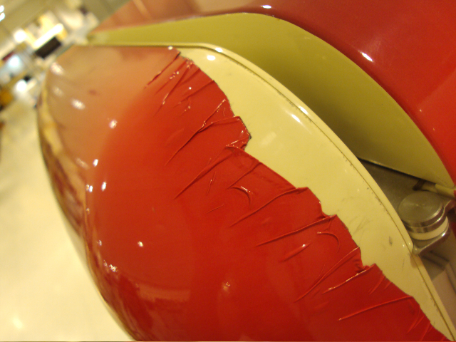

    The fridges have a few rounded edges, the reason I want to go for this is that another company used a different material from what they were advised.
    I have attached a couple of images of what happened to the fridges on the shop floor of Selfridges. – I’ve never seen a wrap shrink back so far before
    The client has been lucky enough to get another shot and I really wouldn’t wish to be the company that puts the nail in the coffin for him.

    17 June 2010 at 18:37
    not being an expert, that looks more like poor fitting looking at the creases, shrink back wouldn’t cause that and possibly the wrong vinyl 🙄

    17 June 2010 at 19:25
    AS Lynn rightly points out, thats just shocking fitting not shrinkage.
    It looks like they tried to fit it over the curve without heat, hence the creases.
    Matt
  • Richard Urquhart
    17 June 2010 at 21:06
    Have those creases appeared as an after effect of the vinyl shrinking back, surely these would not have been on the job when it was handed over???
  • Richard Daniel
    18 June 2010 at 07:14
    I spoke with the client who assures me they were immaculate upon delivery, which is what baffles me the most, if someone on the shop floor had noticed they were peeling back, I can understand them lifting one up, but surely they wouldnt of done it on both?

  • Chris Wool
    18 June 2010 at 08:18
    i think that due to the large amount of stretch given to the vinyl at the corner, it failed due to the wrong vinyl. as its not just one corner may rule out cleaning.
    what has the original co had to say about it.
    personally i would not use any vinyl on that unless it said suitable for extreme contours on the tin(box).

  • Matty Goodwin
    18 June 2010 at 19:28
    Richard
    Just out of interest, are the fridges switched on on the shop floor?
    I can 100% say that that is not vinyl shrinkage. All the suppliers here will tell you that will not happen over 6 months regardless of material.
    If your worried about failure, sure, go for the wrapping vinyl. In my opinion it isn’t necessary and a waste of money, but if it makes you sleep at night, go for it!
