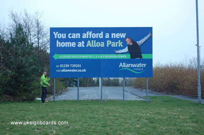

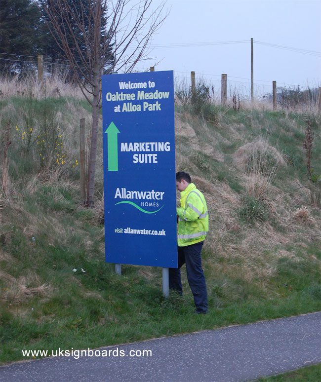

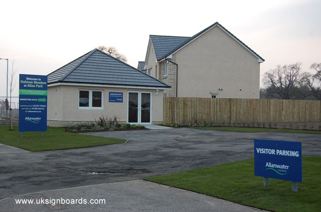

    Just thought ide post some pics of the work i was doing today.
    all pretty basic housing site signs fabricated, printed and installed/erected by us on only a few days notice for an opening tomorrow.
    we did not design these signs, the design work was supplied by a design house, we just produced everything to spec.
    I cringe when i see the bloody big arrows on the signs, but what can you do, out of our hands. anyway, have another couple of big ones to do for next Wednesday so cant grumble.

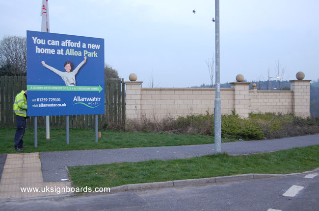

    Great work Rob – that 2nd sign is massive, did you put a beacon on top to warn off low flying aircraft.
    Seriously though – well done
    :appl: :appl:
  • Graeme Harrold
    3 April 2009 at 23:04
    Its only 4’x10’…………………Rob is holding it up :lol1: :lol1:
    Ill get me jacket before my account is suspended 😮
    3 April 2009 at 23:20
    thanks phill… 😀
    Graeme, the guy in the picture is David, hes actually 6’4". i come up to his knee. 😀

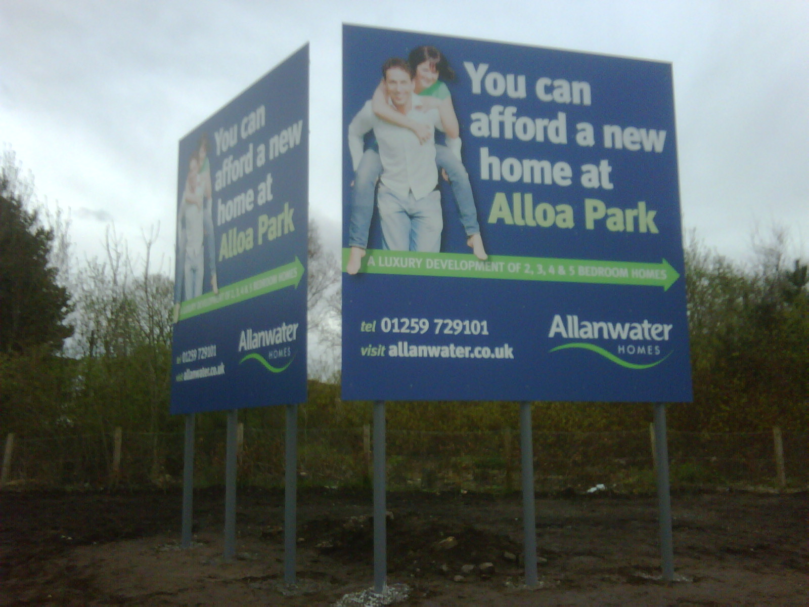

    Martin the signs are all composite board. the channel is fixed onto the composite by 4-5inch strips of 3M VHB tape accompanied by a rivet every strip. this is more a belt and braces procedure when using the likes of dibond/aluminum. particularly with composite board, the VHB + Rivet helps spread the pressure load on fixing area because composite tends to be a soft substrate and the rivets can be torn through the face of the sign in high winds.
    5 April 2009 at 19:10
    Good work Rob
    Not sure If I would be confident on the large sign withstanding a high wind though, What size poles did you use?
    5 April 2009 at 19:46
    Not sure the pole sizes for the big sign peter because, although i did all the others, i did not install those posts, though i think they were 5 metre posts. [those ones were existing posts]
    we were replacing the signs on a like for like basis, i.e. composite board.
    so i had to take the big one down and replace with ours. the sign i took down was composite and although badly made, it was still in perfect condition and was about a year old. in fact, the posts were pretty badly put in too and gave me allot of greif trying to get the panels to close up properly. i also think there should have been 6 posts in place rather than their 5. again, this was another time consuming pain in the rear because i think 2 posts should have been removed and reinstalled with new plus one extra. but anyway, as i said, this was a rush job and we had only a few days to print, fabricate and install.
    the large V-shaped one i am putting up this week will be done using our own posts so should be easier installing.
    The VHB tape coupled with rivets is a very good bond and has never let me down yet peter. [touch wood] :lol1:
    5 April 2009 at 20:12
    Rob, not concerned about the panels, just that posts of that size, can easily just bend at the base in a high wind. there is no bracing to the rear, as with a diagonal strut from about the centre of the post to the ground,the force of leverage even with a light wind load, would be quite high.
    just thought it should be pointed out, as anyone doing the same sort of job, with that post arrangement, could be liable if it failed.
    I am quite suprised that you fitted the panels to what could be an unsafe installation?

    In this example you don’t know what diameter the posts are and whether they are steel or aluminium. I suspect they are 112mm dia. (judging by comparison to the lampost on the right which is a 136mm dia. post) and as a consequence I would consider they are more than adequate.
    Secondly – the client has specified he wanted new panels fitted to an existing post arrangement. At what point do we question the clients rights to replace panels on an existing set of posts with a like for like arrangement.? Had Rob turned around to the client and said "I’m sorry but the posts are not up to handling the size of signs being fitted – the client woud have laughed and said – they’ve been up for more than a year now without any problems – if you don’t want to do it I’ll get someone else that does.

    5 April 2009 at 23:48
    Phill
    yes, I am being critical, (is that not one of the reason we show our work to others) the poles look insufficient for the area of the sign,
    Rob is quite capable of answering my questions, and justifiying his reasons for doing the job as it was done, as it is, if you can quote the wind loadings relevant to the signage area, and fulcrum load at the base of the poles, I will bow to your better judgement,
    I dont see a need to apologies, for stating my concerns about safe installation, if the posts are sufficient, thats fine, if the posts bend next time there is a high wind, who will be responsible?
    Assuming Rob has used 4, 2440×1220 sheets for the large sign, the posts appear to be no more than 95mm, the picture is easily scaled up to calculate this.
    Just because the signs have been there for over a year is no reason to assume they will stay there for another year.
    Rob has stated the posts were not fitted to his satisfaction, hence my suprise that he fitted the panels anyway.
    10 April 2009 at 21:16
    Hi Peter
    Your correct the poles were not fitted to my satisfaction. but that does not mean i considered them unsafe in anyway, I do not know where you got that from mate.
    There were a series of sign erections which required poles to be installed.
    The large one didn’t, we only had to take down the old and fit the new panels, "as instructed".
    when i arrived on site i noticed 2 of the 5 posts where slightly "out of line" that’s why i commented about the install as i would rather have replaced two. because two were out of line it created allot of problems trying to align the new panels to close up tight when forming the jigsaw, so to speak.
    there was only 5 posts, where i would have used 6.
    Basically the sign is made up of 4no. 10"x5′ panels stacked in pairs of two.
    I would use 3 posts to hold the two panels on the right and 3 posts the panels on the left.
    the lack of a post in the middle meant that the four panels "shared" the middle post.
    the only way we could acheive the installation was by copying what had been in place before and that was by interlocking the sign channel on the rear by about 3-4ft. [which was not necssarily an issue as we were copying previous signage]
    In a nutshell, the signs themself were very secure and fabricated well, "by us"
    but the way the former sign company had erected the sign gave "US" installation problems on that one sign, nothing more.
    The sign that was up before ours was the exact same size and had been up a "minimum" of a year. it is in a remote area and completely exposed to winds without ANY problems at all. so the wind load should be fine as its been "tried and tested", even if not complying with the whole wind load calculation theory.
    further more, if it does not hold its own and the posts bend/lean back in a freak storm because of how another sign company installed them. then that does not make "us" liable to fix it, we manufactured and installed "the panels" on a like for like basis "as instructed".

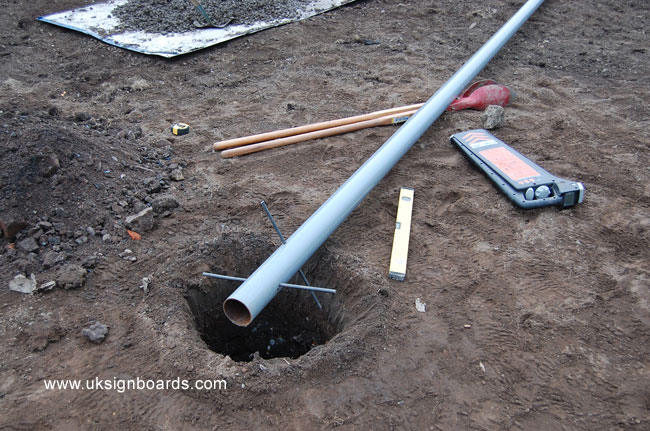

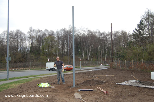

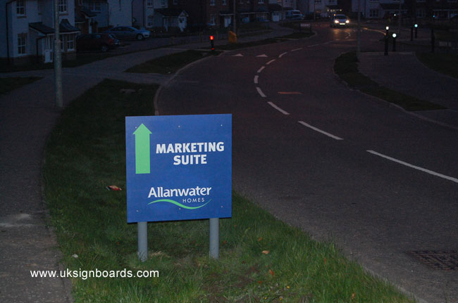

    i have attached some pictures. one poor quality from a phone.
    the pictures are of the last install this week.
    one shows a post in place.
    the other shows the two latest signs "same as the big one being discussed" but this one with a 6th pole as i advised, even though it is two sep signs.
    And the other picture is just a picture of the steel pins we drill and put through posts as it really does aid the stability of the post. im sure i mentioned this prior or in another thread. 😀
