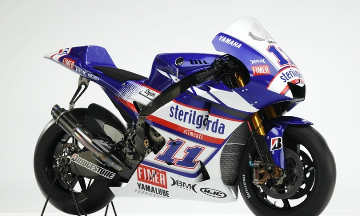

    Hey everyone.
    Really hope I’m describing this correctly (and in the right place).
    I’m trying to replicate that fade out effect you see in single colour at times. The best picture I have to describe it is just below the seat of the bike. I’ve tried but I just can’t get it right. The problem is the transition from cut out of the solid to coloured dots.
    Hopefully that’ll give an idea of what I’m looking.
    Any help greatly appreciated as always
    Thanks 😀

    12 November 2009 at 15:39
    A bit like this?
    http://www.uksignboards.com/viewtopic.p … ght=dither
    if it’s then needed as a CUT vinyl you can just vectorise it.
  • Kenny Ramsey
    12 November 2009 at 15:41
    That’s exactly it David, thanks.
