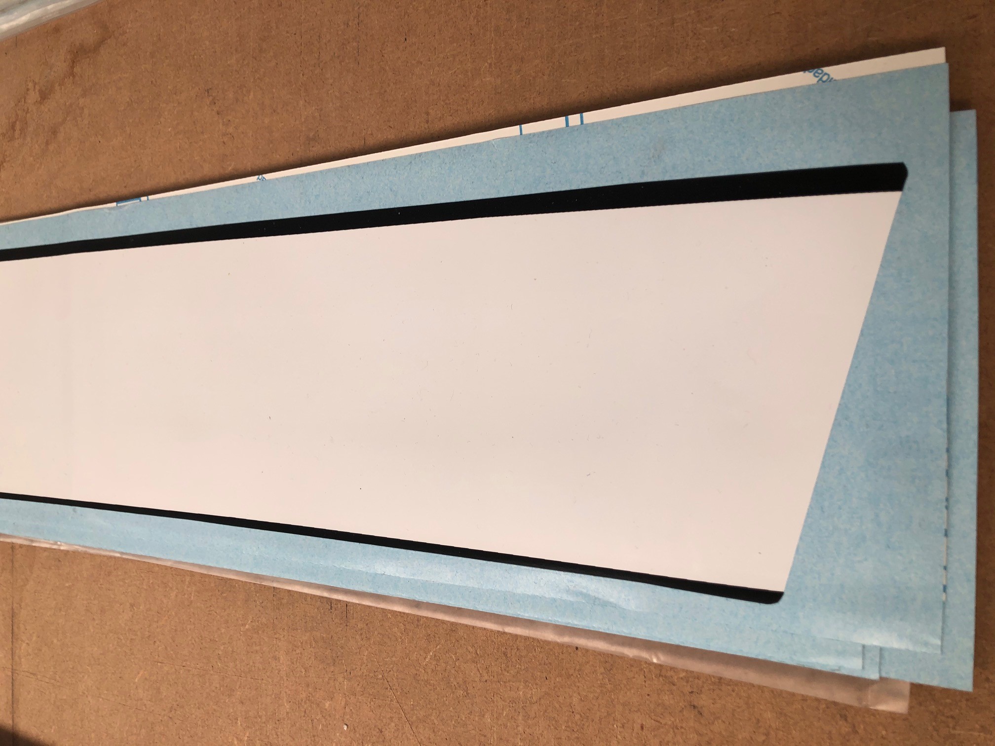

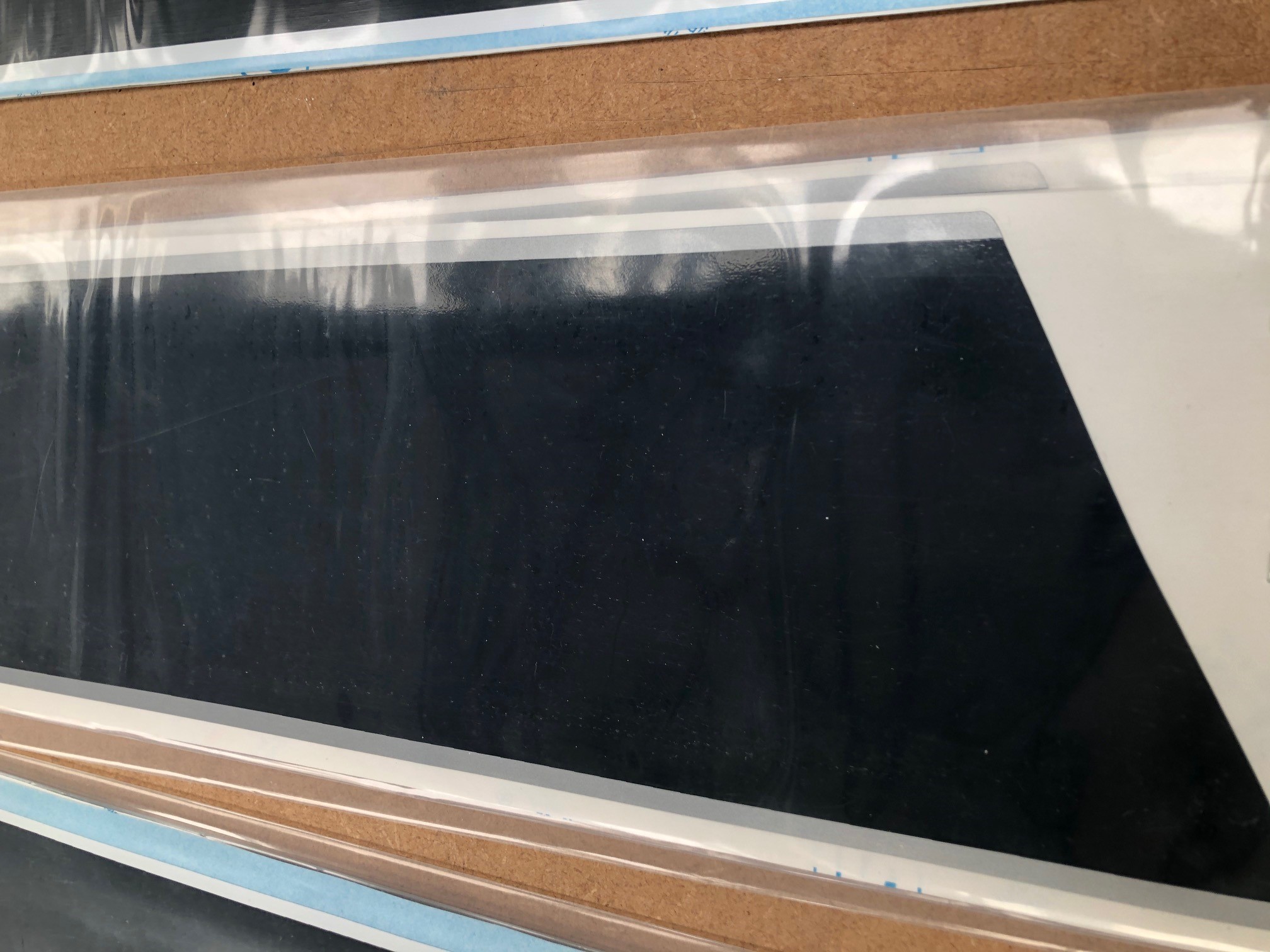

    Hi Guys
    a few short years ago we had supplied bmw mini stripes which were 2 coloured in various colour ways. so mainly they were black stripes with a silver 6mm edge. We use to use a gerber edge for this which made a great job. We no longer have this machine, but want to do similar work. Is there a solution out there to be able to do this type of metallic printing, which can be used for vehicle graphics.
