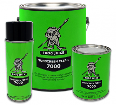

    The liquid laminate from way back then was called frog juice, I think the alternative is called super-frog.
    I first found this around 1998 and I would use it occasionally on our Roland PC60 prints, I posted an old demo back then. Normington and some others began using it on their solvent prints, but I had switched to vinyl laminating by 2000.
    it’s great for small jobs or short runs, especially if you don’t have a laminator. I think some folk use the roll-on type liquid also.
    This was way back then, there are plenty new alternatives on the go.
