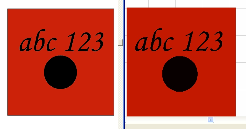

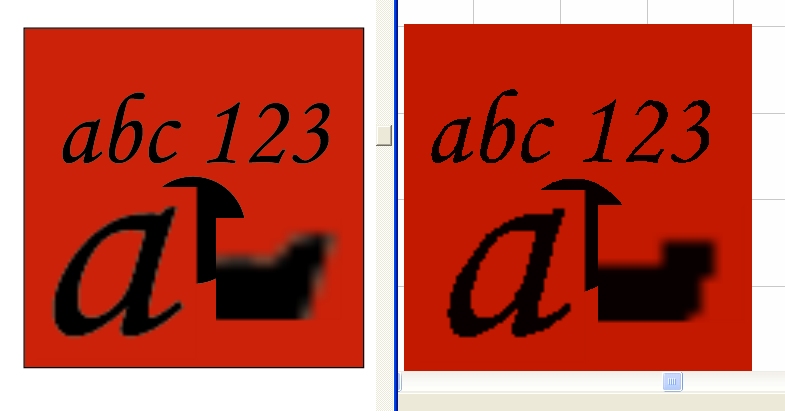

    Heres a screen shot of What I mean
    Illistrator appers to smooth its output where as Signlab dose nothing
    you will see this if you zoom in
    it might not seem alot but it makes a hell of a difference when designing
    my screen res 1600 x 1024 and this image is a good 25% of screen so its a lot worse for small stuff.

    I dont have Signlab – so someone else here may be able to help more – but I think what you are seeing is down to ‘anti-aliasing’.
    Illustrator does it, Corel does it – maybe a signlab expert can tell you whether there is another button to click on in that respect (or maybe Signlab doesn’t anti-alias – I have flexi 7.5 and that doesn’t anti alias either which is a pain).
    Martin

  • Kev Titcombe
    6 September 2010 at 10:06
    Thanks for your input Guys at least I know its not completely me
    "Yes Iam Very Fussy with graphics at times"
    Martin yes this is definitely down to anti-aliasing you can see the shading on the left "illustrator" of the screen shot,
    I just find it hard to see why such great piece of software hasn’t got this incorporated, there are some really good features in signlab which I like but the lack of smoothing, anti-aliasing spoils it big time
