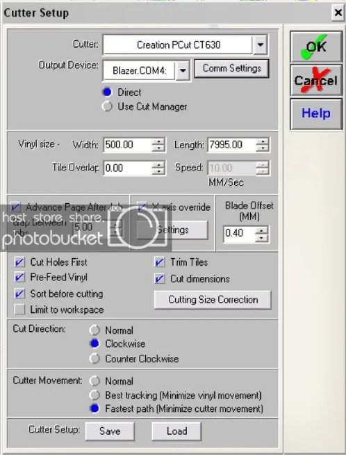

    in answer to some of your questions, let me share some of my findings regarding my Pcut630 and Signblazer software, Im no computer geek or a master vinyl cutter like some of the guys on here, but i will try and help:
    Regarding the data transfer:
    I connect the cutter through a USB lead and I have 5 usb sockets on my computer. There is one socket that i always connect my cutter too, and that is reserved solely for my cutter and nothing else gets plugged into it, the reason for this is that I found that if I use it for anything else, the drivers get screwed up and dont seem to want send the data. I used to use Com port 2 for the cutter but tsomehow whilst i was playing it got corrupted, and now I use COM port 4.
    Regarding the letter shaping prob:
    Just check that there is not too much pressure on the blade, as this will cause the vinyl to bunch up and slip slightly, thus not giving clean cuts and finishes on the letters.
    And if anyone is interested here are the settings i use for my Pcut630 within Signblazer:
    Also On the cutter itself, i have the speed to no more than 50, the cut pressue set to 105.
    hope this was some helps as its 3.15am and my eyes are closing!

    Russ – thanks for the screenshot – we did have on COM4 but still the same unfortunately, nevertheless I really appreciate all the info. We did have intermittent probs before (eg starting/stopping printing – more likely to be COM port issues) so if we get the cutter quality sorted we may well then be able to use your info to rectify the other probs.
