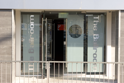

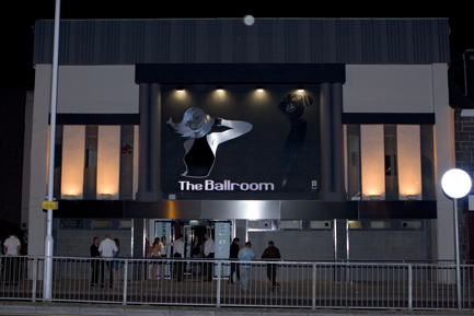

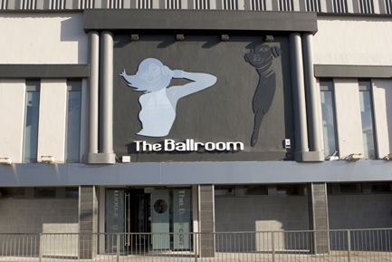

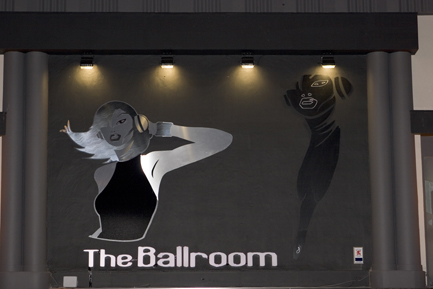

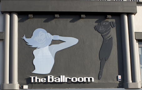

    Our latest project from design to installation. Lady on the left frombutler finsish reynobond highlighted with polished stainless steel (body, hair, wristband and other highlights) lady on right from marine ply. Lettering fromAshby illuminated with Ashbys white LED’s. Etch vinyl on doors infilled with chrome vinyl

  • Adrian Hewson
    16 July 2005 at 08:41
    and in daylight
  • Adrian Hewson
    16 July 2005 at 08:42
    finished now

  • Iain Gordon
    16 July 2005 at 09:08
    That looks cool mate
    Just wondering why you didnt do the girl on the right in the same way as the one on the left?….She doesn’t seem to stand out, even in the daytime.

  • Adrian Hewson
    16 July 2005 at 09:53
    Hi guys thans for comments.
    We have worked on this project for many months now (most of it in the design stage) originally it was only going to be one lady running the full 17ft drop of the front of the builing. We had much more details on the lady including bikini bottoms and cleavage, however we could not get planning permission. So we reduced the left hand lady to 12 ft and cut off her legs, but that left a degree of emptiness on the fascia so we agreed with the client we would put a shadow effect of what the original lady was going to be and that is the black lady on the right. I might add that these pictures seriously do not do justice to this sign.
    Stainless steel lady was routered out of 18mm marine ply and screwed very seriously to thewall, then a cover of butler finish dibond was routerred out and fixed on top with contact adhesive and also screwed where it was going to be covered by the polished stainless steel, then the polished stainless steel was fited over the butler finish using 3M VHB tape.
    Letters were a nightmare we fixed to the wall using brass locators but the profile of the was more like the Pentland Hills (Range of hills at the back of Edinburgh) so we had to use spacers to kepp the letters level

    16 July 2005 at 21:23
    very nice mate, like that… even the ghosting image. also like the etched doors.
    have you applied the mirror first then etch over it or is it etch on the inside and foil on the outside of glass?
    not sure of how you fixed the big logo mate. what size was it? i think there must have been an easier way to fix/fabricate that… but hell. easy for me to say once the jobs up i guess. 😕
    great stuff adrian. thanks for taking the time to post mate. 😛
  • Adrian Hewson
    16 July 2005 at 21:32
    The Big black logo was actually put up in about 1 hour. It is about 14 feet long. We cut the shape out of of a 10 by 5 sheet (only cut the top two thirds then lined the rest up by eye)of 5mm foamex. Lined up on fascia secured with two screws, placed big lady inside then screwed straight through put in 50mm rawplugs and and screwed home, when we were finished covered screws with black silicone.

    Sorry Rob, thanks for comments forgot to asnwer your other question.
    We use a lot of etch vinyl as we do a lot of hairdressers, quite often find that the etch on its own lacks something so we often infill with chrome.
    As a genereal rule we lay etch on first then infillw ith chrome and always on the inside of the window.
    Thanks everyone else for their comments
    Regards Adrian
    16 July 2005 at 21:41
    ahh i get you now. its cut out then laid in? we do this sometimes but normally leave a halo of space around a coloured vinyl. like you say to give it something extra. i personaly dont like it as i think etch should be used to imply a bit of class. however i think the chrome works btter than colours. i have never tried the chrome coupled with etch. well done mate. 😉

  • Adrian Hewson
    16 July 2005 at 21:57
    Hi Rob Re Cherry picker
    Lady on the left was seriously heavy, three man job, at her widest she is 8 ft, could have used a scissor lift but not a cherry picker, but main contractor supplied us with the scaffold free( we installed the mercury lights at the top as well).
