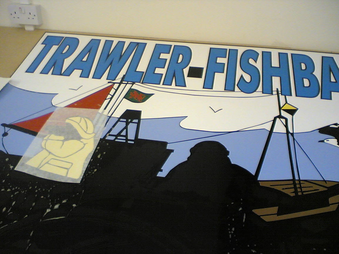

    I thought Id post this for people to have a look at. Design was hand drawn by a local artist and she wanted it made into a sign. I decided to make it using vinyl only so I could keep the colour vibrancy she wanted. Took me a little while to scan and clean up the vectors but once done cutting and applying was fun 😀
    Apart from the white part at the top everything was applied wet.

    7 October 2005 at 12:03
    A couple of piccies showing how it was put together

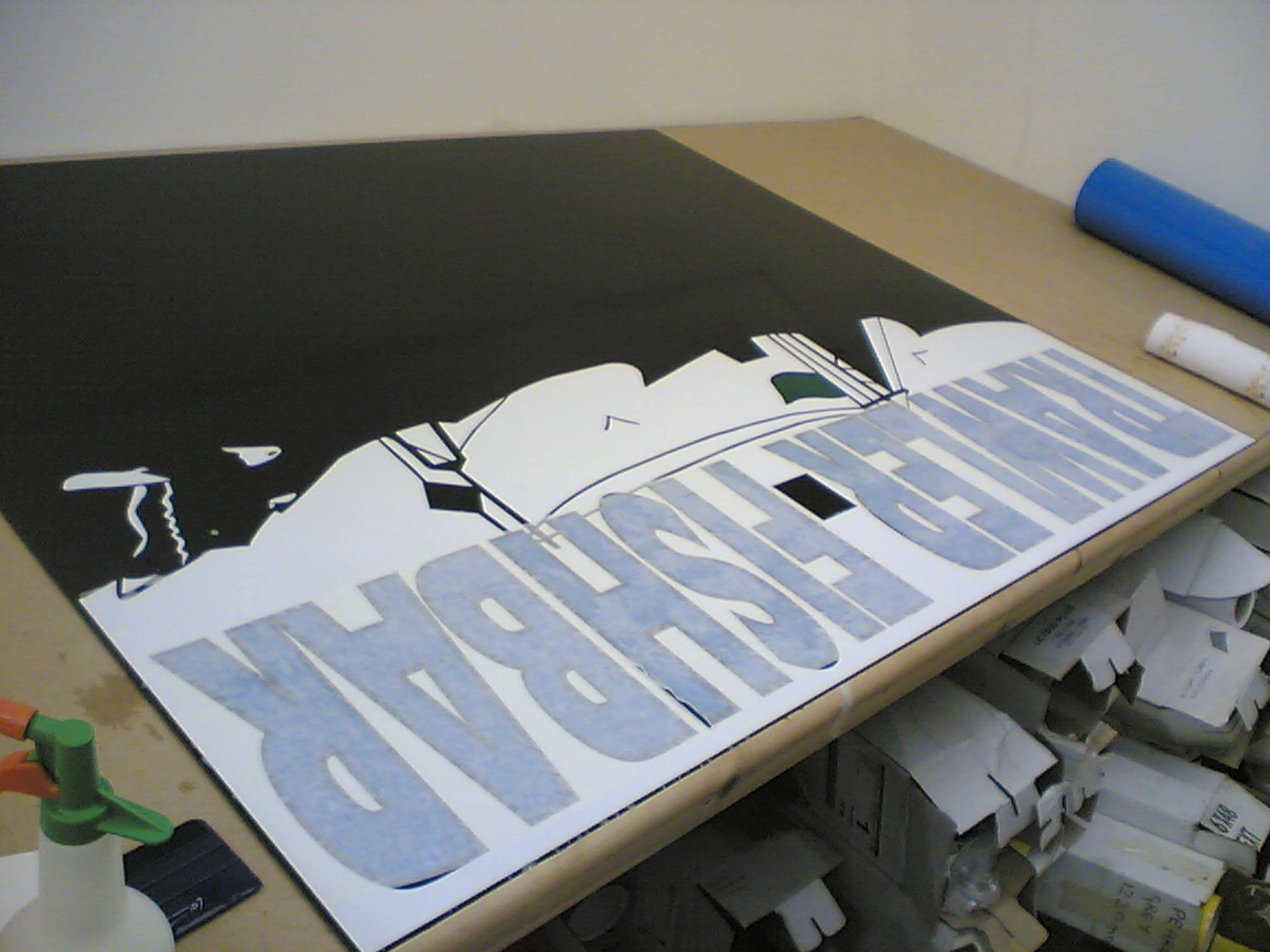

  • Jayne Marsh
    here’s the other one

    Took me quite a while to scan and vectorise the artwork I think about 6 hours maybe less, it was one of those jobs that I kept coming back to as it turned my brain to mush after an hour or so. cutting took about 1 and a half hours and applying took just about the same.

    I was lucky that I had a piece of dibond as an offcut from another job, also I had all the colours I needed as left overs from previous jobs because otherwise the job would have been a non starter due to having to buy in so many materials and the additional cost this would have incurred.
