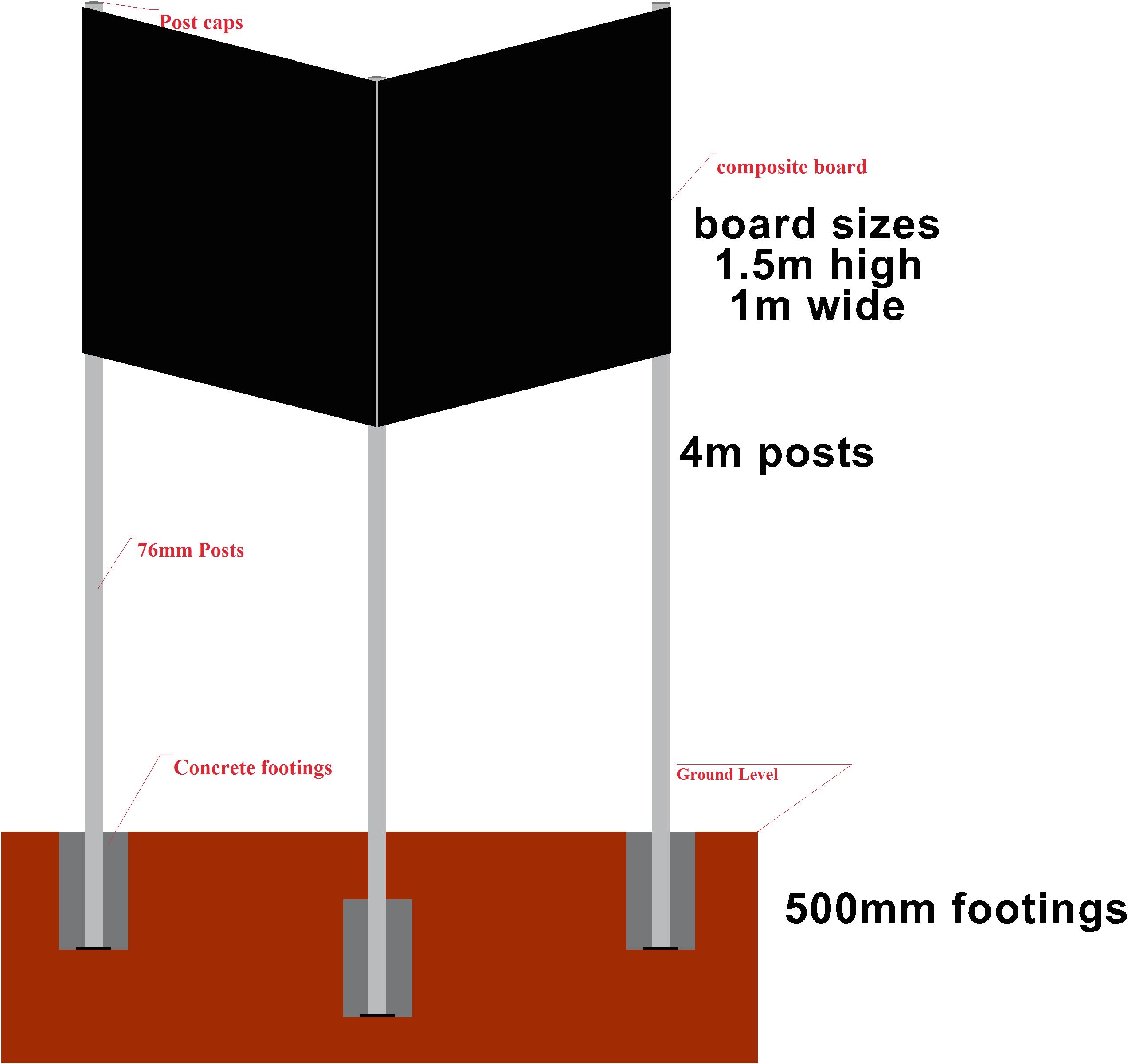

    don’t mean to hijack the thread.
    i have posts to plant this week and was wondering if i had planed it right
    take a look at the mock up.
    is 3 rails on each board ok?

    Scott – 3 rails will be fine, but your footings are only about half as deep as they should be…seriously…
    If I were doing it – it’d be 900mm minimum.

    ill take your word then (better to be safe than sorry) also there will be cars parked by the side of the sign
    anyone recommend a seller. (on the posts/rails)
    priced the job on a quote of Blackburn metals.

    not that its hard to tape and rivet the rails. they recommended me to have 500 mm in the ground with base plates.

    David is right about the size of footing. If you install this with only 500mm support, the local prevailing wind conditions could give you a problem. The V board could under certain conditions become like a giant sail, with no where for the wind to spill, thus your turning moment becomes greater than the force holding it in the ground.
    The other factor to consider is ground condition. If the ground has been recently disturbed, the natural soil compression could be compromised. I know its a pain going to that depth, but it is better to be safe than sorry.

    as you can see in my mock up iam attaching 2 signs to the front pole to make the "v" shape
    is this possible?
    looking at robs demo he has used 2 poles?
    17 April 2009 at 19:40
    You will need to "stagger" the rails Scott. By that I mean make sure the rails are at a different height on each panel otherwise they will prevent you from mounting two panels both at the same height on the centre post. It can be done though and the tripod arrangement will make it quite stable. You can improve the stability further by bracing the two outer posts together (to form a closed triangle in plan view). Do this simply by attaching sign channel rail between the two outer posts using conventional post clips.

    not if you use these Dave(bottom of page 1)http://www.rennicksuk.com/uploads/File/Brochure.pdf
    But i have to agree 500mm is not deep enough mor like 900mm / 1000mm especially with 4mtr posts

    I Spent 18 Years installing signs Neon, Fascias, Canopys Etc and One little tip on fitting signs like this is when you buy your concrete buy a few breeze blocks or bricks. Like has been said dig the holes 3 foot deep and wedge half pieces of block around the post on all four sides of the square hole. Level up the sign and really hammer in the blocks, this way the sign will stand up on its own and should be quite firm. You can then make slight adjustments to the level of the posts. Then fill with concrete. This way the sign is standing up on its own perfectly solid and will not move so you can be confident that it will stay in this position while the concrete sets after you have left.
