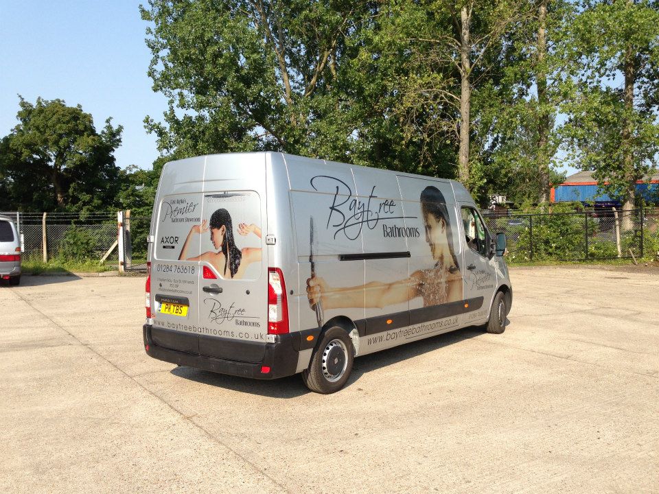

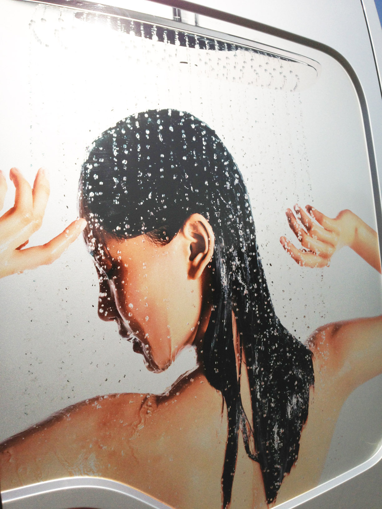

    Hi John,
    Some nice jobs there.
    Was the Bay Tree side done as a full wrap on clear?
  • John Dorling
    23 July 2013 at 16:09
    Hi Peter
    Not a full wrap but yes it is on optically clear cast so the metallic silver shows though. It gives a really nice effect, but you have to be careful not to touch the back of the vinyl or get dirt under it! The sides are wrapped from the rubbing strip to the gutter, and from behind the door to the rear panel join.

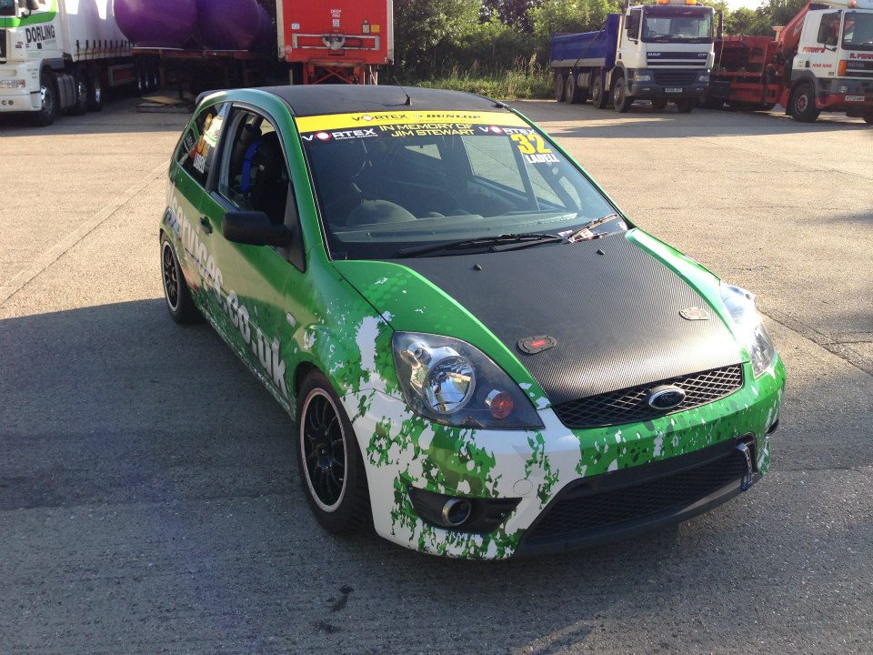

  • Neil Davey
    23 July 2013 at 20:37
    Very nice work there John.
    What material did you use on the Fiesta?
  • John Dorling
    23 July 2013 at 21:44
    quote Neil Davey:
    Hi Neil
    Thanks! We used 3M IJ-180 on the Fiesta. It went on really well. We used 3M Di Noc black carbon on the roof and bonnet.
