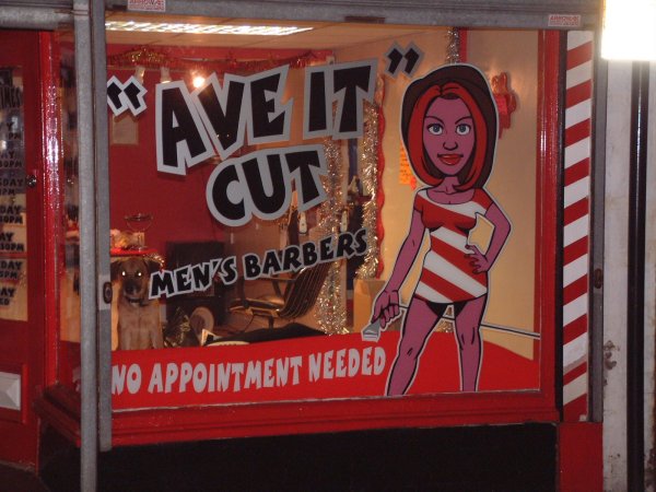

    This is a window graphic I did today for a barber shop in a nearby town. She was very specific about what she wanted colour wise and wanted a caricature of herself in the window, so thats what I did 😀
    All 751 vinyl, took about 5 hours to apply it all (there’s opening times, prices etc on the door and side window). Vectorising took a while as I decided to have a go myself this time, but again, a few hours to do.
    Being a big northern wuss, I now have blisters galore on my fingers and my nobbly knees are aching, but it was all worth it to see the look on ppls faces as they drove/walked past :lol1: They sort of stopped and went 😮 then a big smile. Thoroughly enjoyed myself 😀
    Cheers, Dewi

    5 December 2004 at 18:33
    i think thats great mate… really good 😛
    its very eye-catching/humourous/inviting all in one go… 😀
    i think its in everyones best interest that you got a picture of her and loaded that too… just to see how good a job you have done with the vectorising of course 😉 :lol1:
    oh and buy yourself a set of knee-pads from b&q ware hourse. get the ones that are about £15 heavily padded and hard plastic faces on them. look a bit like scateboading pads but not as bulky.. they come in very very handy. specialy when doing large banners on the ground and that sorta thing.
    thanks for taking the time to post mate…

    :lol1: :lol1: :lol1: I hadn’t noticed that! :lol1: Thats the owners dog, it was keeping me company, holding the vinyl at cructial points, and barking if it saw a bubble 😉
    Robert, I’ve tried using those knee pad thingies, I always end up taking them off half way through the job as they keep getting in the way 😕 I’ve started using an old cussion if I’m outside, but inside I just brave it 😀
    Forgot to thank Big G as well, I tried his method of applying them, with the reg marks, and it was a great success. I missed my paper template at certain points, but I think I’ll use the reg marks in future, saves alot of time and is just as accurate. 😀
    Cheers, Dewi

    Dewi,
    talking about registration marks, did you apply each layer separately on the window, or build them up in the shop? 5hrs seems a long time to fit,
    not not trying to critisize, just rying to save you time. and wear on your poor knees 😀

    I did a certain amount of laying up with the brown, dark red and pink in the workshop, but I prefer to do the rest on the window. Problem is at this time of year, at least I’ve found, is temperature. Too cold, the vinyl won’t stick very well. Too warm, the window steams up and the vinyl won’t stick at all. 😮 I spent alot longer than I’d planned (I reckoned 4 hours) but it was worth it as the lady who runs the barbers was really pleased.
    Yep, I was offered a free haircut, and I need it! 😮 I look like Fozzy Bear atm as I’ve been working everyday for the past 3 weeks without a break, but it’ll have to wait for now as I have too much to do before Christmas week. I only went to check on a customer this morning, make sure they were happy with the results of some signwork I did recently and they want me to do both their upstairs and downstairs windows, so the haircut waits. Who cares if I look like I’ve just stepped out of a 70’s disco, I love my job 😀 😀
    Nik, the artwork was adapted from some cartoons I already had. I vectorised it, then started to add in things like the stripey dress and the clippers. The lady who runs the barbers actually has brown hair with long red streaks, so it was styled to suit. I also had to alter the face a little, as she a very slender lady and I wanted the finished product to look as close to her as possible. I was actually amazed at how much I’ve learned from the vectors that Andrew has done for me. He’s done some great work for me in the past, and I’ve been able to disect the vectors and mimic the style. I can’t do his interpretation though which is where he really makes the difference.
    Oh and leather boot wise, she originally asked for white and red knee high boots, but I took them out of the final design, they just didn’t look right and I don’t think they would’ve added much to the overall design. Could be wrong, but its one of those choices 😀
    Cheers, Dewi

    we have had the same problems with applying to windows at this time of year, its not so much the temparature as the humidity factor that causes the vinyl not to stick. Ive had problems when my own breath was condensing on the glass and the vinyl wasnt sticking, Its like trying to apply wet on windows. Takes for ages to dry out.
    were the graphics put on the outside,? hard to tell from the piccie, but looks like they were,
  • Bill Dewison
    5 December 2004 at 22:08
    All the vinyl was on the inside, I don’t like applying it to the outside as it can get grubby really quickly on main roads. This is on a main high street, so I definately wanted it on the inside. I know its more difficult to apply to the inside as you have to get the vinyl in the right spot first time, but its worth it as it stays clean longer. Plus, I promote interchangable window graphics, where I put white vinyl on the inside, then apply black text to the outside. The black text leaves a really cool drop shadow, plus you can change it easily on a regular basis. Its great for promotions and stuff. 😀
    I know what you mean with the whole breath thing. You get to the point where you literally hold your breath, hoping you’re not to going to cause chaos just by breathing.
    Bob, you’ve been nicking John Singh’s joke book again haven’t you? :lol1: Thats a point, I haven’t seen John in a while, he must be busy as at this time of year.
    Peter, what type of vinyl do you use for window graphics? I always use Oracal 751, but I do that many windows, if there’s an easier vinyl to apply on windows, it’d be great to know about.
    Cheers, Dewi
    5 December 2004 at 22:20
    dewi, we tend to use avery for everything, By sticking to one make it keeps things simple, and we can keep a good stock.
    Works for us, have tried lots of different makes in the past, avery is no better or worse than other makes like for like, just happens we get a good deal on it.

    Top banana, Dew. It must be nice to get something that’s a bit more fun than the usual stuff. You should have asked her to lay on the floor so you could draw around her. Purely for artistic accuracy, of course.
    6 December 2004 at 10:16
    quote Dewi:
    Cheers, Dewi
    Dewi, hats off mate. You’ve done a good job of this. Every right to be proud of this one. 🙂
    I do a lot of window signs, always on the inside. Although I use 751 & 851 pretty much exclusively, if I am laying up several colours, I will always use 3M 7725, with the clear polyester back. (-)
    That way, if you use clear app tape too, you can line each colour up on the glass, using the hinge method. Makes it a snap to do dry, and you have not got the problem of not seeing what you are doing as you go. I find the paper backing makes it harder as you are ‘flying blind’ until you expose the glue.
    Just a thought mate. Makes the job infinately easier. :thumbup2:

    I’ve given the clear app tape a pop but I found it really difficult to work with 🙁 On small work it was okay, but anything over a metre I found I couldn’t get it to hold onto the vinyl properly, and taking it off, blimey! 😮 That stuff won’t rip for love nor money! 😕
    As you say, with the paper app tape you’re working blind which is not fun. The 3M with the clear backing sounds fantastic though, that would be just the job for the type of work I do on windows. I’m constantly drawing on the backing so I can see where the vinyl is from the outside. Thats probably why it takes me so long, I double check everything before I apply a layer. Do you know where I’d find the 3M stuff over here?

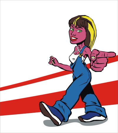

    I’m already working on the next one, a bit more work in this one, but its still at the sketchy stage.
    Cheers, Dewi
    7 December 2004 at 18:49
    is this one a lady builder dewi (?) she looks good
    lynn
  • Bill Dewison
    7 December 2004 at 19:53
    Thanks 😀 Its another hairdresser, again its been customised to resemble the owner. If they don’t go for it though, I’ve done most of the vectorising now, so I’ll either use it myself or wait for another job its suitable for. I am doing a builder one atm, but its a smallish rounded bloke, so the vectorising shouldn’t take as long 😉
    Cheers, Dewi

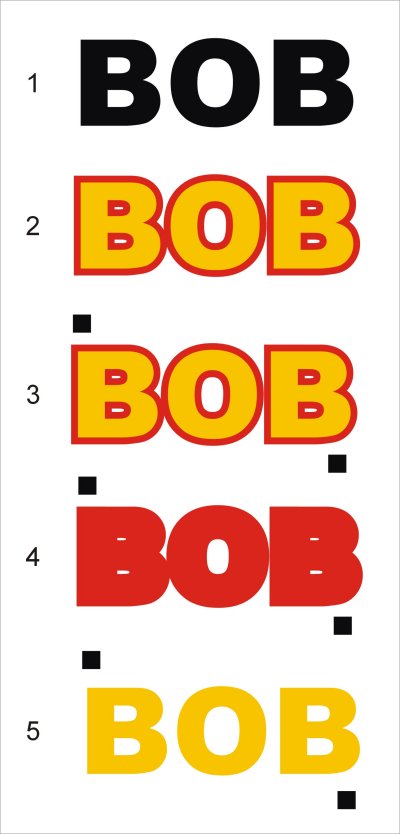

    Sorry if the answer to this is simple but on the fitting side of things, why would you use a vinyl that has a clear backing if its removed prior to fitting ?
    Whats the best clear application tape to use ? I have a couple of signs to do that have contours/outlines and rather than trying to cut everything out to fit I thought it best just to overlay but dont have clear app tape
    Thanks All
    Bob 😮
  • Bill Dewison
    8 December 2004 at 12:46
    For flat signage, the best way to overlay to my mind is using registration marks, you get an accurate fit everytime providing you line up the marks correctly. There are other ways to do it, clear app being one of them, but it relies on lining up by eye, and if you’ve had a heavy night the night before, you’re eyes aren’t the best precision tools 😉
    Cheers, Dewi

    Being a new guy can you explain how I do this “registration mark” thing.
    I use corel for just about everything and then send to signlab to cut.
    PS This is my photo 😮 not a smiley thingy, so my eyes are bad enough when I’m sober
    Bob
  • Bill Dewison
    8 December 2004 at 15:58
    Sorry its took so long Bob, been a busy day.
    K, in drawing 1, you’ve created your text. Drawing 2, its been outlined and seperated. Drawing 3, you’ve added 2 boxes top and bottom in opposite corners.
    Once all that is done, copy the original text with the boxes and thats one cut file (drawing 5) and then the outline (drawing 4) with the boxes. Cut them both in the desired colours and weed them.
    When you’ve taped them up, lay the outline first with the boxes. Then overlay the original text, lining up the boxes with the boxes from the outline. When done, remove the boxes, hey presto, multi-layered graphic and its lined up perfectly 😀
    Hope that all made sense 😀

    Hey Dew, great looking caricatures. Only thing bugging me: the pink used for the skin. Too pink. What about some kind of camel, kind of beigey. Might not be as bright. It’s always a problem – skin tone in vinyl. Someone does a skin colour in their vinyl range, but I can’t remember who does it.
    By the way, where do you get the girly images from. Are they clipart, scanned from something or do you draw them? Not that I’m looking for girly pictures you understand. 😎
    Cheers, Dewi
    Using registration marks, but with clear backing and clear app tape, you can still hinge them with no dramas. Lets you see through both the app tape and backing, making the registration marks easier to line up.
    The hinge method, especially on glass and laying many colours, using this combination is the easiest application technique you can get.

    Thanks for taking the time to explain that, I really appreciate it. The tricks of the trade you guy’s share are invaluable.
