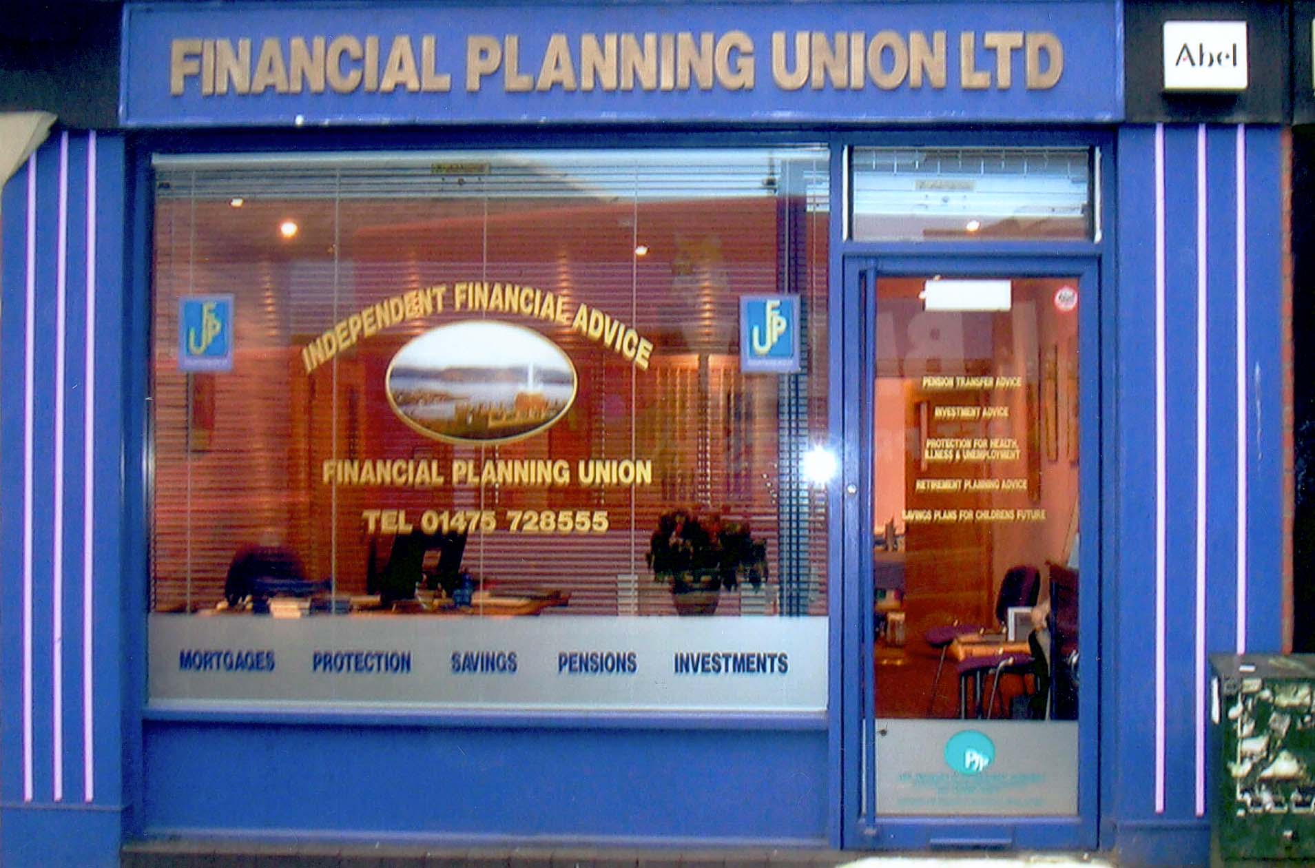

    hi folks just a job that i done about 8 months ago just thought youd like a look 😀 The shops in Greenock ….not my patch i no, so if any ones on from greenock dont get (hot) (hot) . I did the Perth shop so they asked me to do it .The digis a photo of Greenock and the Perth shops got a didgi ….of suprisenly Perth
    Regards Brian
    PSLettering above is cut out in foamx although dont know if i would do that again

    Nice work Brian did you do the picture as well ?
  • Brian Little
    18 January 2006 at 17:35
    no Lynn i must confess i didnt …but all the rest 😀

    Looking good Brian
    How did you attach the raised letters to the facia
    How did you find cutting out all the letters and cleaning them up
    Did you paint the edges of the letters

    hi Paul just used 3m double sided there flush with the board. As i said i don’t know if i would do it again ..a lot of time rubbing the letters down before spraying .I used gold car paint it looked OK …customer was delighted but I’m always a bit self critical

    Yeh, I did the same on the Boslowick sign
    http://www.uksignboards.com/viewtopic.php?t=16418
    Cut letters with jigsaw, lots of sanding, faced with vinyl and sprayed the edges with plasticote paint.
    not sure I would go through it all again, bit labour intensive
    but as it was myfirst time with flat cut letters I wanted to do it all myself
    very satisfying but I think I would source the letters in the future
    Looks good though brian and as long as you made the client happy and made yourself richer it’s all good

    Thanks Paul .I tried putting vynil on them but my gig saw cutting wasnt really that acurate and it just didnt look good. better with paint
    Regards Brian 😀

    I put the vinyl on afterwards Brian, then trimmed the vinyl with a stanley knife.
    paul r

    What kind of vinyl is best to stick to foam board?. Signs look great!

    im using macal 9800 just now but oracle 751 is excellent as well ….very east to weed

    ye Paul thats the problam i aint very good with a stanley knife ….i think it stems from my childhood when watching val & john on blue peter when they said “remember ask an adult before you cut on the kitchen table ” i didnt 😀 😀 😀
