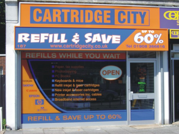

    Posted by Andy Gorman on 6 August 2004 at 14:35
    I’ve just fitted this lot this morning and now I’m knackered. All on a south facing shop front in the blistering heat, and on my own. Will someone please give me some sympathy. 😀

    Nice Job this heat is something else app fluid evaporated before you have time to work with it But looks great!!!!!!!!!!

    looks very nice!!
    like the colour combination, one Q what did you do about the orange over the logos did you get a ‘halo’ effect around them with the orange on top? Or does the orange have cut outs ?
  • Andy Gorman
    6 August 2004 at 15:06
    I know what you mean about the halo effect. The orange went on very well over the logos and I couldn’t see any evidence of a halo. Possibly because the orange is quite a bright colour and the halo is not as visible as it can be with a darker colour overlaid. I considered dry application at first but the heat ruled that out so I gave the window a spray of app fluid and it went on a treat.

    only cons. critisisum……..yes you can (bully) punch my lights out !!
    the telephone numbers kerning is a bit unevenly spaced out!! 😳 😳
    sorry big g, but i would not be able to sleep tonight, if i did not mention it!! 😀 😀 i have to say what i see 😛 😛 😉 😉

    Seriously though, really smart work! As has been said, cool colour combo, and I like the OPEN oval. I know its a bizarre spot to concentrate on, but I did one recently and they’re a pig to line up, especially in hot weather.

    Yes, I noticed that Nik – once it was on the wall, that and the fact that the web address could have been a bit smaller. Never mind. I don’t mind you mentioning it; I wouldn’t have posted it if I didn’t want to hear peoples’ opinions. 🙂
    Funny you should mention the oval, Dew. That’s the only bit I didn’t do, it was already there. 😀

    Is there a roller shutter on this shop? Did you fit a signboard over the roller shutter (if there is one) and if so, how did you go about attaching it?

    Thanks Dew. The “refill & save” etc is a Cherwells proframe mounted onto the shutter box. Had to cover the frame in vinyl because they don’t come in orange and I had only 2 days to make & fit. Some of these shutter boxes are made of quite thin steel so I always put plenty of good quality screws in and sometimes a decent quality VHB tape as well just for extra security. You have to be careful not to snag the shutter inside with the screws, but if you keep to the edges of the box there’s no worry of that happening.

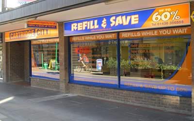

    Did another one of these a couple of weeks ago and another in Wandsworth on Sunday. Don’t do much else worth posting, so here it is.
    Picture aint up to much; it’s from the customer’s website.

    Nice job ..I dont envy you with all that overlay on glass… how do you avoid trapped air around the letters… whenever I do overlays on glass the letters always end up with a slight discolouration around the edges..

    I think with both of the colours being quite bright, any outline of air is barely noticeable. Looked fine, even up close.

    how long did you take to do the windows? 😀

    About 3 hours Nik. I must have been on something that day because I fitted the whole lot in about 5 hours. Mind you, I’ve done a few of these now and you get a bit quicker the more you do repeat jobs.

    i think you always manage to create a bit of impact from your shopfronts, keeping the overall look consistant. well done…
    noticing the large corner sections etc.. how do you find the new cutter wisth now that you can cut parts like this in one bit?

    It’s a Godsend having the larger plotter. Not very visible in this photo is a block of text in the middle of each window. Now I can cut this in one piece, fitting time is massively reduced. The curved corners used to be cut by hand after application, now it’s cut to shape before fitting. Best decision I ever made, spending the extra bit on a 1220mm plotter.

    couldnt agree with you more mate.. stacks of text on glass and vehicles are a doddle in one go… curves etc.. i know exactly what you mean.
