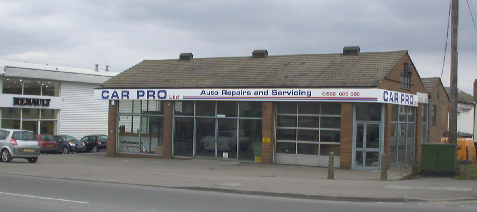

    Just finished this today, all the panels were routed and folded by hand,
    The original timber frame although a bit warped, was used.

    Thats a lot of bending Peter 🙂
    how did u join the bits together if you don’t mind me asking
    6 March 2005 at 14:57
    3050 lengths x 630mm. I did consider making a join but they were rigid enough just to but together, screwed in place through top and bottom returns. The timber frame was 4 x 2 so was rigid as well.

    Blimey Peter, thats well smart! 😀 Has that been done in a similar way to the Rich posted the other day?
    Clean and simple design though, looks the business.
    Cheers, Dewi
    6 March 2005 at 23:46
    Thanks dewi
    more or less like rich’s demo, but no end corners. the bit that does go round the corner was the hardest bit because the frame on the short side
    of the building wasnt square with the front. It was done by a friend of the customer, to save money,

    Is that a panel coming off the substrate with locators
    The piccy a little small so I can’t tell
    6 March 2005 at 23:56
    John,
    Its all vinyl no locaters involved. just posted it to show the versitility of dibond/reynobond etc.

    Must be a grey strip underneath giving the appearance of another panel fixed on top

    Nice job Peter, I love using this material because the finished signs always look so good and its an easy material to work with. Trouble is most people don’t want to pay the extra money for a better quality material.

    7 March 2005 at 12:33
    nice work..
    what fixings did you use..?
    are they visable?
    cheers
    jon
    7 March 2005 at 14:05
    used non rust screws on top and white plugs from cherwell on the bottom return.
