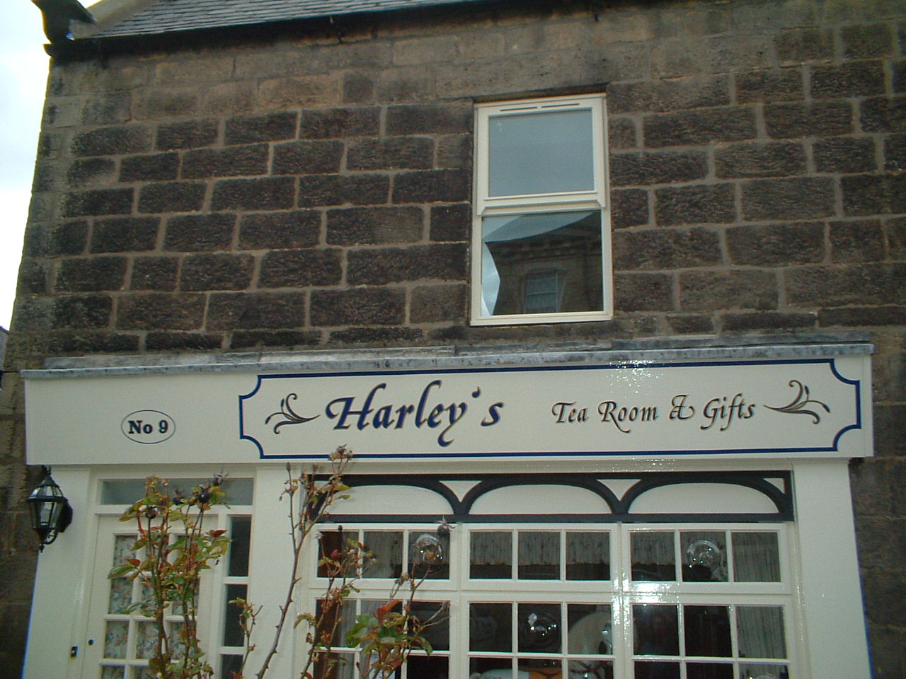

    sorry, i haven’t worked out how to optimise pics yet? could someone explain in very simple terms 😳 this is a sign that i did a couple of days ago and it turned into the nightmare from hell. It was freezing cold and the vinyl had to be applied directly to the fresh gloss paint! I’d cut the sign too long to start with and had to jiggle around with cut and shutting the border. The vinyl would not stick at all to the surface and i only had a rubbish step ladder (and eight months worth of pregnancy bump to contend with) I spent seven hours in total up the ladder in despair, freezing and nearly crying with the thought of the low quote I’d given the customer. In the last hour, my bloke turned up whose experience of fitting vinyl extends to “i’ve fitted a few stickers to cars in my time”, I asked if he wouldn’t mind starting to position the last bit for me, he scaled the ladder, simply ripped off all the application paper in one go (much to my horror) and placed the last bit of text ‘ harley’s’ outline and lettering absolutley perfectly in minutes!!! This was after I’d spent hours – squeegie in hand, meticulously working away. Needless to say, I was pleased to get the job done and the customer was over the moon but what’s going on? I swear, vinyl can SMELL FEAR.

    Apologies to anyone who’s read through that essay, there were a few things in there that raised some questions for me which I’d appreciate any tips on if anyone feels inclined: is it ok to apply vinyl to gloss paint, will it come off or eventually bond with a little bit of sun? Is there anyway to sucessfully apply a border like the one on this sign in one bit or is it always a bit by bit thing? is there any sort of varnish or sealer i could put over lettering and gloss paint? (for example matt polyurethane varnish to make a matt effect and seal the work) can vinyl really smell my fear? perhaps i need to be more assertive with it? cheers! nelijane

    Vinyl will stick to gloss just fine as long as the paint is hard enough. You should always allow at least 3 or 4 days of good drying weather for the paint to get a chance to harden enough. It depends a lot on how the board has been painted… several thin coats are better than one or two thick coats as the paint has a much better chance to harden. I have had jobs where the boards have been painted by the customer with one thick coat to save him/her time, or so they thought, but the lettering could not be applied for over a week until the paint hardened enough.
    If you can leave a thumbprint or tear the paint with your fingernail, then it is too soft!
    Soft paint will give off solvent vapours which can affect the adhesive on the vinyl.
    If the customer insists you apply to fresh paint, warn him/her that if it comes off, it will all have to be re-done at their expense. You will usually find they will wait a few days.

    thanks james. this paint had been on for about a week and it certainly seemed hard enough! maybe it was a combination of the high shine and the cold weather (it was only about 6 deg) i would love to be able to find an exterior wood paint in anything but gloss finish, i have an aversion to it!

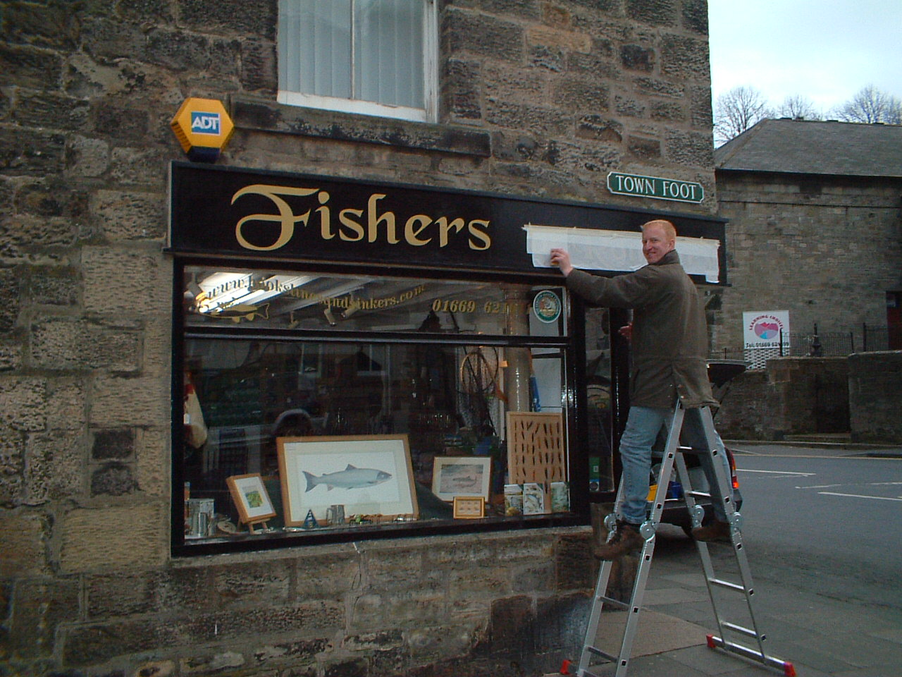

    Dewi, have taken your advice seriously, this is my bloke, Paul, up a ladder fitting for me!

    nice stuff nelijane!! i like the salmon shop facia, gold on black always looks terrific!! 😛 well done!!

    Your chappie looks mighty happy there NeliJane 😀 Blimey though, you’re getting about with this signage work aren’t you! Nice sign btw, did you do the window graphics as well?

    thanks guys! Paul does look very happy up that ladder doesn’t he. Bless, he didn’t even ask for a cut!
    I did do the window graphics as well, and for minimal effort, I was really pleased with them. The simple gold on black thing worked so well, the customer was really happy with this sign. It’s a fishing shop in my home village and lo and behold, over the next couple of days, I’d been approached by five other shops of the same street for quotations! The village is my gallery (I’m obviously getting above my station)
