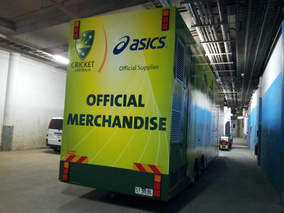

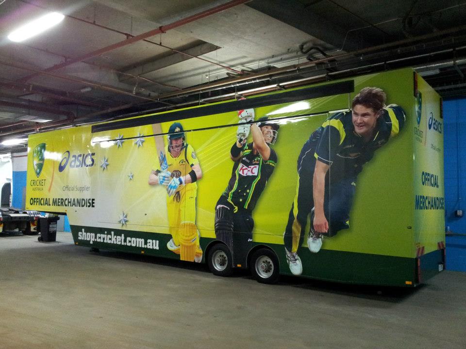

    This is a short term wrap but because the client was upset with the quality of the previous wrap by another sign shop who used a matte material that was unlaminated. The client found it hard to clean and being matte, felt it was very dull. Added to that, the previous shop had printed in draft mode and the colours didn’t match at the joins.
    We opted for a 3M3552 cast temporary film, and we applied over the top of the old signage. We also laminated it with a 3M high gloss laminate. Its only on for 3 months until the end of the cricket season, then it will change to another sport.

    lovely work shane 😀
  • Warren Beard
    14 January 2013 at 20:02
    can’t see it Shane, that big awesome wrapped trailer is in the way 😉 😀
