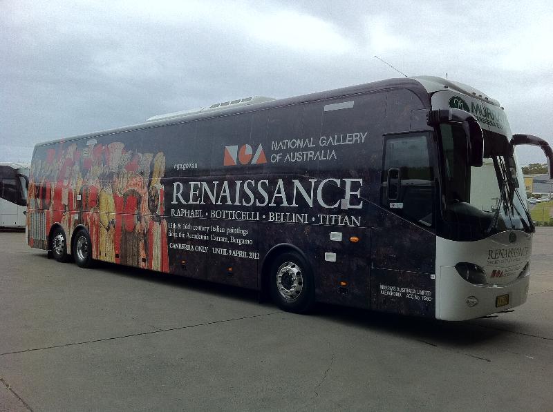

    3M 3552, liquid laminated with Clear vue on the glass and laminated with 3M 8518 Laminate.
    The weather was very humid making the application a bit harder than I’d have liked, but we got it done eventually. Took two of us 4 days in total….

    How do you do the liquid laminating?
    13 December 2011 at 12:35
    quote Jon Marshall:
    Jon, I have an aquaseal liquid laminator, as well as an ezytaper and an electric laminator.

    It was on TV in Canberra, and everyone was very impressed. Made my client very happy, and me even happier.
    Only problem I had was that the client drove it interstate not long after I did it. It rained for the 18 hours it was on the road. As a result, the constant rain got under a couple of joins and they lifted as a result. I had to fly interstate to meet it at its destination to trim some edges, but all was sweet, Like any wrap, I usually do a final inspection the next day, once it has had a chance to settle, but the deadline was very tight on this one. I’ve never had an issue, this was my first…. and it ended up 1500 klm’s from my workshop. Murphy’s law I guess.

    Great work as usual Shane, any particular reason you went for a liquid lam on this one????
    Look on the bright side, it could have ended up on an international trip and a lot more than 1500km away :lol1: :lol1:

    Martin, I usually liquid laminate to keep the costs down over vinyl laminate. The main reason I did this one is because they wash the coach every day. As it is on for 4 months minimum, I wanted the print to have some longevity, especially because of the daily wash. The coaches I do that are only on for 6 weeks, I don’t worry about lamination though,
    David, My son and I took 4 days to fit. I did all the ladder work, and my son helped me with every thing from below the window line. He hates heights 🙁
    Jason, yes, both printers ran for 2 days. I dedicate each printer to each side,
    Derek. It was 36 here yesterday, with massive humidity. I rather the cold to be honest 🙂

    Martin, they range from a month to 6 months in longevity. My client only advertises companies that sign up for a transport package, so it is not general advertising in that sense.
    It is usually advertising special events where he is the exclusive transport operator, so rarely adverts would run longer than a few months before or during the event.
    Otto, I rarely do the design for these things. I advise of the design, that is about all, telling the designer areas that should not have critical data, especially in the areas that need a bit of stretching.
    I have only had one design that was 200mm short over 15m, and it didn’t work when I went to fit it, I was 1500klm from the office, but we got around it somehow. I always take my offcuts with me, and if it is an area I know is difficult, I’ll often print another one just in case, so I have a spare.
    Preparation is the key, especially when I travel such huge distances to do a fitting.

    i sympathise fully with you regarding humidity, even when working indoors the humidty gets to the vehicle unless you have a temp controlled room, which is unlikey with this size of vehicle. the humidity can turn the best of wrap films into a tacky nightmare.
    i know many look on buses as big flat panels but the amount of finishing work and osmall obsticles that get in the way are very time consuming when done correct.
    we see general city centre buses out on the road regularly plastered in wraps but this type just dont do the same job. they ARE hung like wall paper. they are not wrapped. simply bridge anything in theor way and butchered when cuts have to be made. i know these firms look on the wraps as short term and work on tight budgets, but still…

    I know what you say mate, but buses are a lot harder than they look to be honest. We can’t remove any of the lights or accessories on these buses and the Chinese factory decided to glue all the lights onto the bus frame. The bus owner was livid. Goodness knows what they’ll do when a bulb blows…
    The local council buses here are the same as you say. Put on wet usually, and they tent within weeks. Usually a cheap monomeric too. We use cast on all our bus wraps, and we have to guarantee the film will not damage the bus, paint or the signs we go over in the wrap process. If it does, we are liable for any expense in repairing the damage that is caused,
    That is why we do the entire job dry, and we insect the vehicle and photograph damage before we start.
    Never had an issue yet, but the previous sign shop did. I learned from his lesson…
