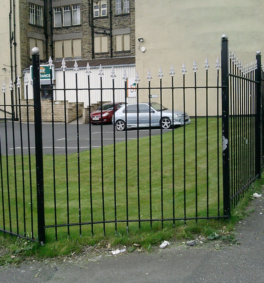

Home › Forums › Sign Making Discussions › Neon, LED, Lighting › Securing to a railing fence Neon, LED, Lighting Securing to a railing fence Posted by Stephen Ingham on 14 August 2010 at 21:08 Hi all, can anyone advise me on how best to fit a flat panel composite sign board to the railing in the picture? Any help and advice would be appreciated. cheers stephen Attachments: Neil English replied 15 years, 4 months ago 6 Members · 6 Replies 6 Replies Derek Heron Member 15 August 2010 at 16:59 hi stephen jag supplies do some fixings for mesh fence which would work or i would cut strips same size as your panel and bolt through the fence derek George Elsmore Member 16 August 2010 at 07:04 chanelled back with bolts and angle ali behind the fence with clearance holes tighten up bolts and voila Gary Birch Member 16 August 2010 at 07:21 quote George Elsmore: chanelled back with bolts and angle ali behind the fence with clearance holes tighten up bolts and voila Same here. But I once drill and tapped a hole and then fixed the sign with socket button screws, this worked well but wasn’t the easiest way Cheers Gary Stephen Ingham Member 16 August 2010 at 12:11 Thanks for all your replies, i’ll let you know how we get on… cheers stephen Fred McLean Member 16 August 2010 at 13:43 Monster cable ties 😀 Neil English Member 16 August 2010 at 16:23 channel and "d" clips Log In to Reply Log in to reply. Public All Members My Connections Only Me PublicAll MembersMy ConnectionsOnly Me Public All Members My Connections Only Me Log In to Reply Start of Discussion 0 of 0 replies June 2018 Now
