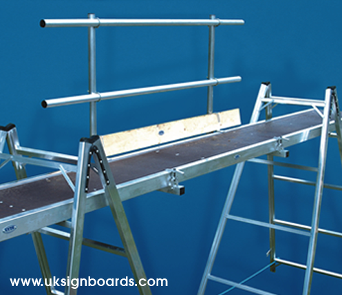

    I would never buy a scaffold tower for our line of work and it is a last resort if I ever do have use one.
    I use Aluminium Trestles and Staging for all sign fitting.
    If we cannot use the trestles because of height, we switch to a cherry picker.
    We have 10ft Trestles and 10ft Staging. fits perfectly into the back of our vans.
    We fit everything from factory, shop and trucks from this access equipment. it is light and fast to setup. a couple of minutes and its up!
    Roughly speaking the platform is be about 10ft up, you stood on top with your hands up is at least 7ft, thats 17ft of reach, upwards and walking left to right for 10ft is a great span top work on.
    Scaffold is used all the time in all industries i get that, i have also for many years but you have to erect it, its filthy, it takes up a lot of van space or its on the roof which takes time loading and unloading and inconvenient.
    then take the signs, a 10×5 sheet of composite being passed up the inside is a nightmare without damage or its up the outside of the tower. all risky and as said, damage to the sign. it is also a tiring slog climbing up and down the tower for everything and anything. a cherry picker keeps you sweet with H&S and speeds up the installation no end. so where the customer pays for the cherry picker, they save on man hours on the installation.

    15 October 2016 at 14:27
    We dont have a long wheel base either, mid wheel and short wheel base vans.
    The SWB van has a slightly shorter trestle in it but works equally as well.
    They are very solid and stable, unlike ladders etc. they are great for large van and truck vinyl installs, where scaffold is a nuisance.
    As said, once your scaffold is in the van stood on its side you really occupy the space that would otherwise be able to accommodate signs and tools. I used scaffold for 10 years and still "if i have to" use them, but i switched from scaffold to proper aluminium trestles about 16 years ago and would never go back.

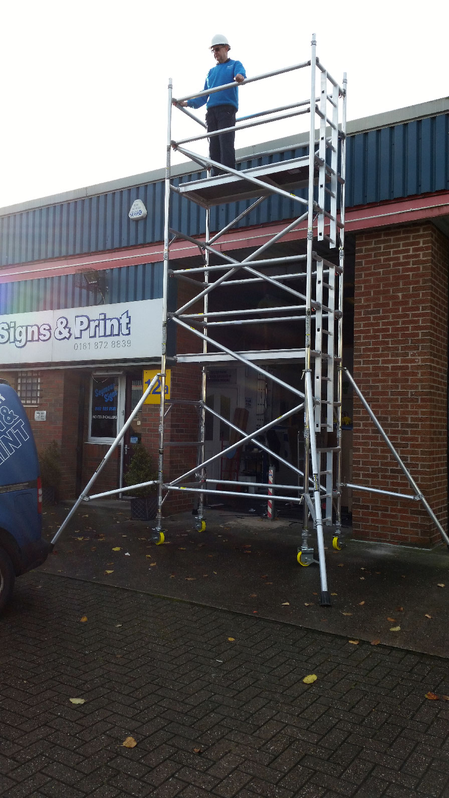

    17 October 2016 at 11:48
    It’s arrived this morning, so we spend an hour putting it up and taking it down again, then seeing if it fits in the van.
    Fits in the transit a treat, and we can still get an 8×4 panel over the top with ample room to spare. :thumbsup:
    Chuffed to bits, the thing has hardly been used, still has the labels on the parts from the manufacturer.

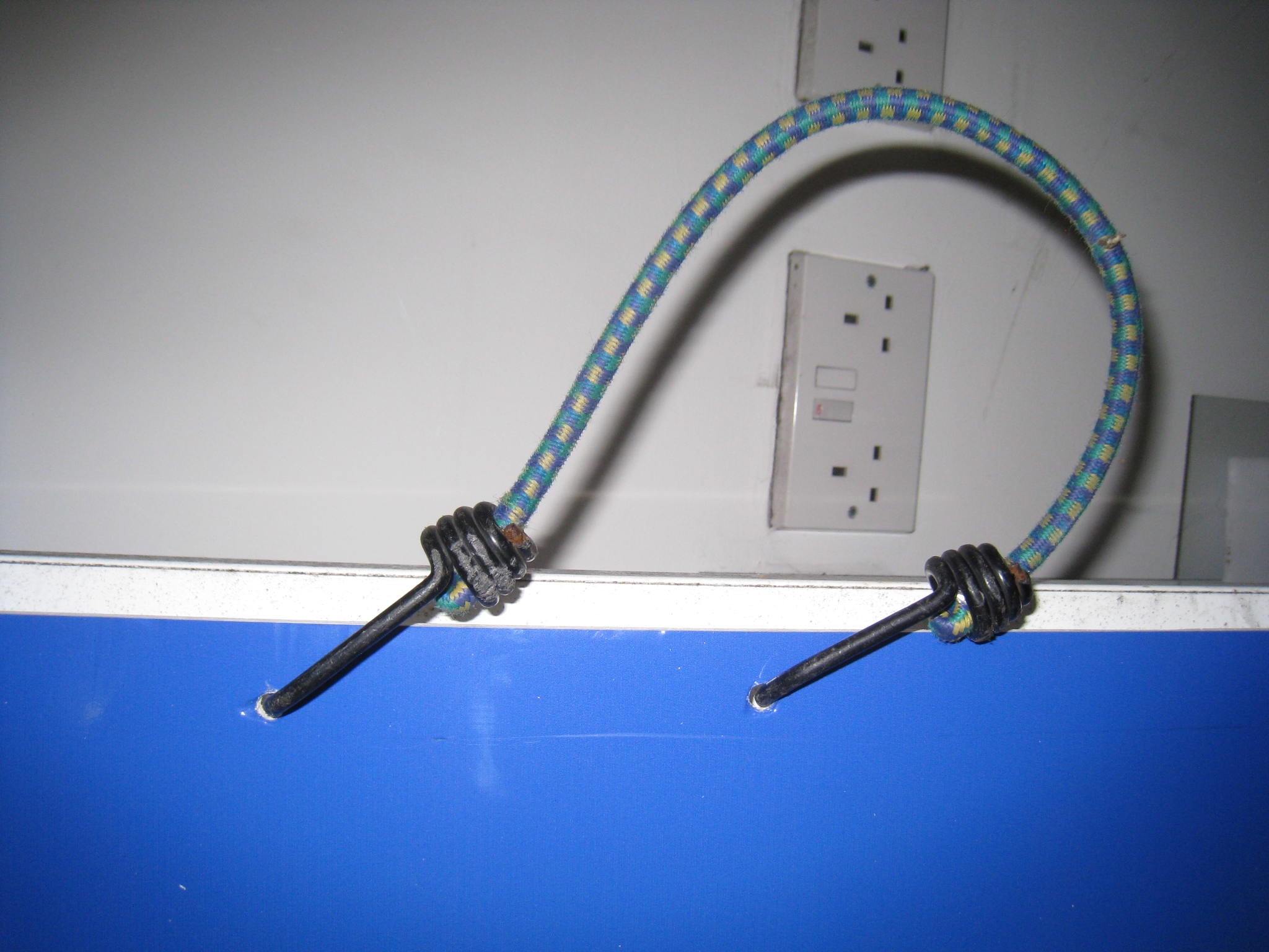

    I usually drill a couple of holes near the top of the panel (or on the return if it’s a folded pan) – fasten a bungee clip, then haul the panel up using a tow rope fastened to the bungee . This is fine when fitting a sign into a frame or when fitting folded pans as the holes will not be seen once the panel is in situ.
