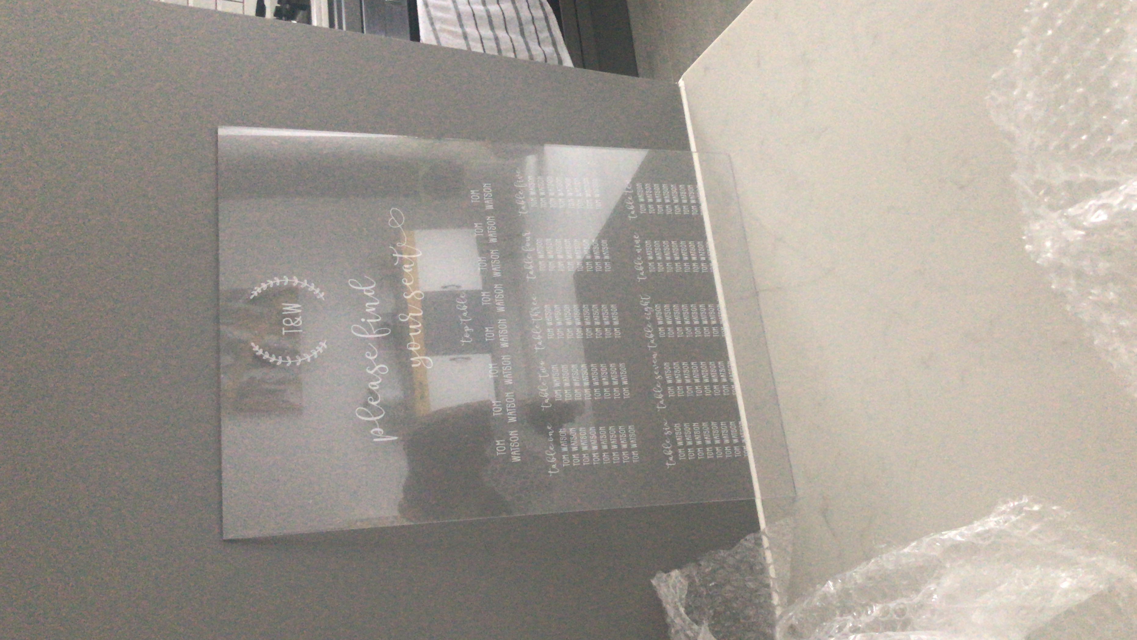

    Hi All
    Hope you are well. I was asked to produce an acrylic for a wedding venue supplier – they want us to provide options on an ongoing basis. The quote was for clear acrylic and white text. I have an Epson 80600 with the white channel so I used clear SAV and then mounted. Some dust got in there but is to be expected. Just wondered if anyone else does this at all and any issues I may experience? The majority are only going to be up for a max 48hrs but they have some long terms ones – arrows, general signage (acrylic again) – so I don’t want to have issues. I presume polymeric is the way to go?
    Sorry for the poor image – customer sent me this! He’s happy though!
    Neil D.

    18 October 2018 at 13:56
    cut the entire thing in white cut vinyl in reverse.
    do not weed
    apply the entire thing in one go (un-weeded)
    once applied…
    now weed it by snapping back the vinyl in short bursts. it will leave all the letters exactly as you want.
    no blemishes in the clear vinyl or need to worry about dirt below the film now…

    18 October 2018 at 14:08
    Thanks for the reply Rob!
    I did think of doing it this way, my concern was how small the text goes down to – especially in larger weddings as this place can hold 200 apparently. If that’s now smaller text it’s going to be a pain to cut on the summa and then weed between the usual letters – o, e etc. I’ll give this a go though as I’ve not actually tried it.

    19 October 2018 at 08:00
    Did a set of vows a couple of months back on 10mm acrylic (that I had sitting around).
    Flame polished and put white vinyl on the rear…part weeded then stuck on as Rob says.

    19 October 2018 at 09:14
    quote Robert Lambie:
    Why white on clear though, How will it be mounted?
    For something so short term and important the guests the guests can easily read it, seems a bit of an odd request.
    A, cost and B, legibility….
    granted, some weddings have money to burn, but still…
    not quizzing, I am just being nosey :smiles:
    Customer wanted one solution for his clients and it was going against grey walls, similar to his kitchen in the background. It would be held there on stand offs. I agree though, there are better ways for him to do it, probably backed in white completely with clear acrylic. He seemed to think this was ok. these guys have money to burn but also it’s costed in with the wedding so ultimately it’s the newly weds who pick up the bill!
    I’ll definitely try the other way now though, although I still like the fact I can whizz it through the easymount with a little trimming back as opposed to weeding. Everyone’s different I guess!

  • Neil Guppy
    19 October 2018 at 09:45
    I`ve laser engraved these before. The engraving on clear comes out almost White. Just another option if you have one or know someone.
  • Steve Morgan
    19 October 2018 at 10:12
    Regardless of which method you use for the text I wouldn’t even think of doing the job on acrylic, it’s too soft and will scratch far too easily each and every time you remove some text especially if you use cut text. A piece of glass by comparison will allow heat, solvent glue removers and even careful use of a razor blade scraper, it won’t attract dust and it’s clarity is far better than acrylic. A local glass merchant will cut the holes in a laminated panel.
  • Phil Davies
    22 October 2018 at 16:44
    We produce things like these on our Roland LEF-20, after lasercutting. A lot of people use them as invitations, or we can print upto A3 in signs. Its a lot simpler for us, as we primarily do lasercutting. Like you say, some people have money to burn for weddings!
