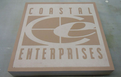

    This is an example of a sandblasted Precision Board Plus HDU sign:

    These are all Precision Board Plus HDU sandblasted signs by the experts at Insignia:
