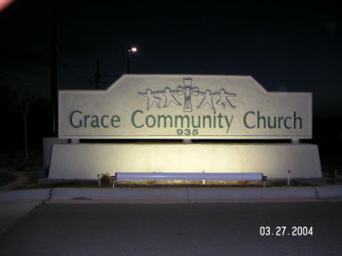

    Posted by csigns on 28 November 2005 at 17:26
    this sign is 6ft tall by 20ft long. it is all out of sf3 sign foam and it is sandblasted

    Wow, you’ve been busy matey. Lots of interesting work there. Don’t you ever have to make any small signs? 🙂
    28 November 2005 at 21:08
    nice one mate, that has to be the largest signfoam sign ive seen. 😮
    how long did it take make this and how long to fit?

    yes i have time for small things too just work them in when i have to wait on think for the bigger jobs. small jobs is good for fill in.
    it took me about 2 weeks to make it but not a full 2 weeks some other small jobs going on too and about half a day to fit.

    how would you mount/fit a sign like this mate?
  • csigns
    28 November 2005 at 21:37
    the top and bottom is in 2 parts there is a frame work inside the top with 3 pipe coming out the bottom. then the bottom has 3 slightly bigger pipe so the top will slide rite down into the bottom pipe. and the base is block than covered with stucco. the pipe go thru the base into the ground about 3 ft with concrete and a slab for the block to set on trust me there is a lot of brain power goes in to something like this. in total this sign weight is about half a ton

    now thats a nice big sign….good job done there 😀
    i wouldnt know where to start on a sign like that 😮
