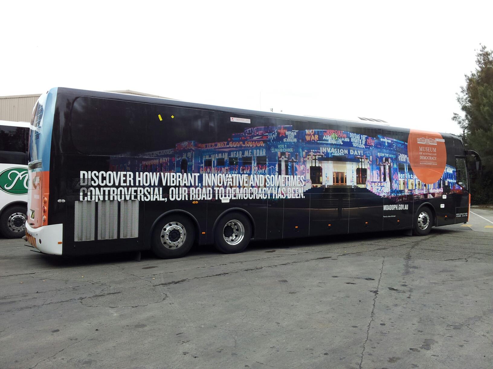

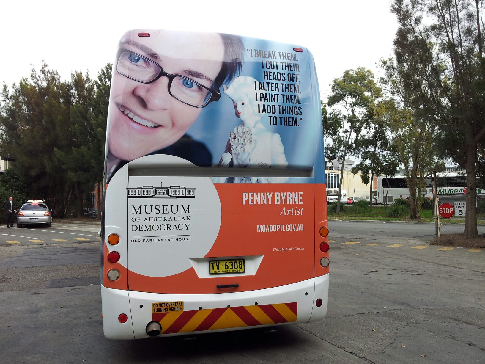

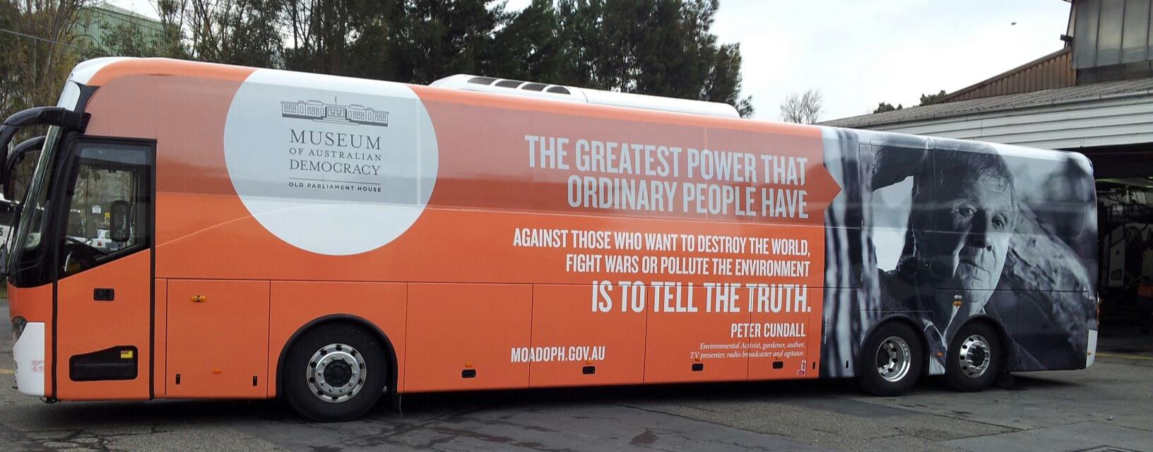

    Posted by Shane Drew on 28 July 2012 at 11:42
    Ex Blues Bus job, now advertising for a museum on democracy. Ironic as we have a ‘former’ paid up member of the communist party as prime minister now….

    Driving the 1000 klm’s to Sydney and being so far from the office if something goes wrong adds a level of stress, as well as the sheer size of these vehicles – nearly 16 metres long and almost 3.6m high. It can be very daunting. You have to have a fair bit of faith in your own ability for a start.
    As you say tho, the physical fitting is exhausting. I never sleep well while we are away – strange bed, always going over the fitting in my head – and we usually work solid days. Then we have deadlines that can’t be missed, adding more stress.
    My son sometimes gets overwhelmed with the magnitude of what is ahead if the fitting isn’t going as planned. But, I just take each step as it comes, I’m fairly methodical in that way. That is the key to doing these big jobs. It is all in the method,
    The deadline for this one was even shorter than normal, so I had another fitter help me for 2 of the 4 days.
    When I eventually get home, I usually get a massage and or a chiropractor. I ache all over. Especially working on a tresstle with prints that are over 3m each in length. Plus, I’m a bit pudgy which doesn’t help. 🙂
    Come the weekend, I have been known to sleep for 18 hours after a big week.

    as always, great work shane, love the orange one as it has its own form of impact with minimal amount of graphics/images.
