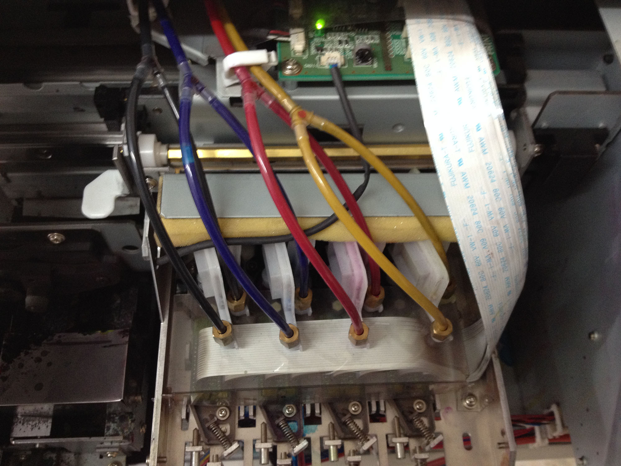

    This "bubble" can affect my print quality?? ive attached a syringe to the capping station and pulled some ink until the bubble was gone, but after a few days its back again, can it be a damper?? or maybe its the connector between the ink tubes?? thanks

    change the damper & the O ring under the brass nut hopefully will cure your problem

    thanks kevin i will order both amper and o ring, ill post results in a few days 😀
    Kev
    I’ll second that. More likely to be o ring in my experience.

    May also be worth checking manifold for cracks if you still have problems
