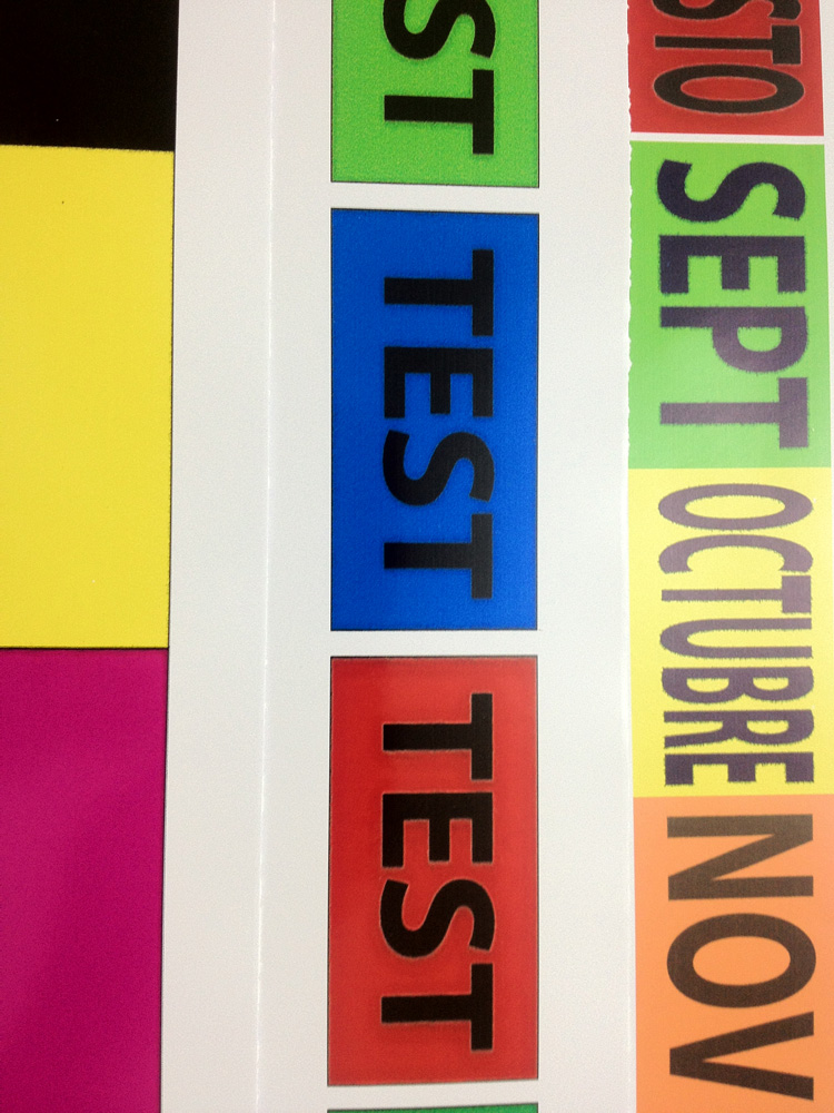

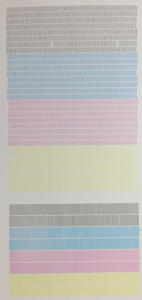

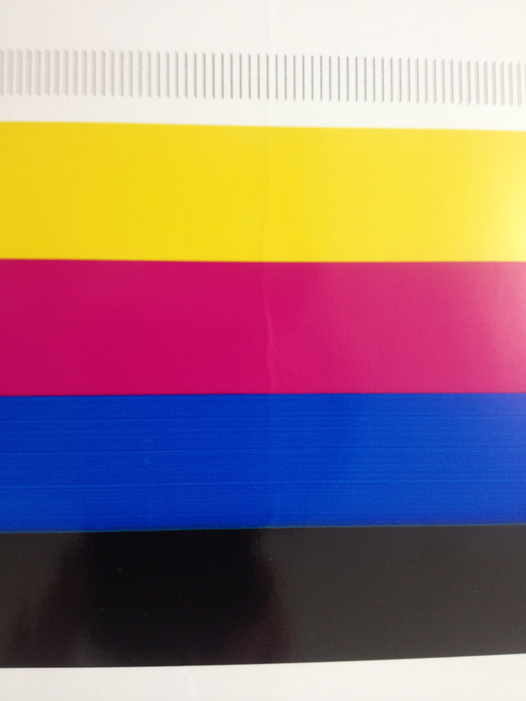

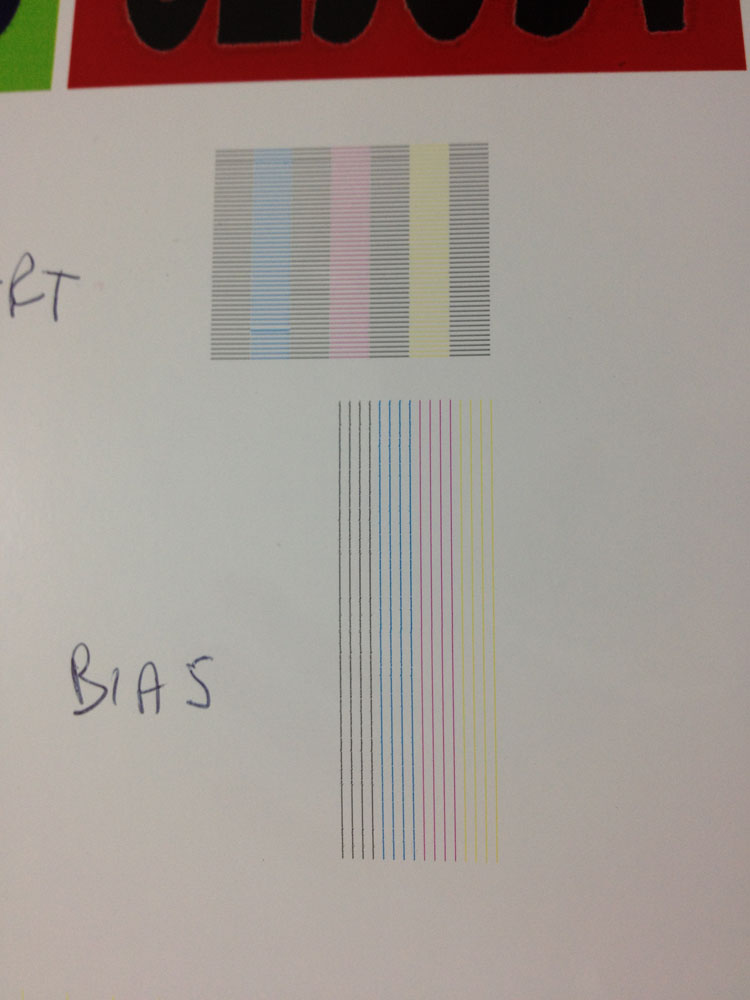

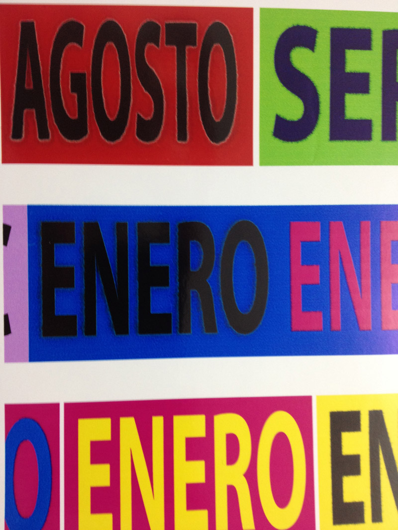

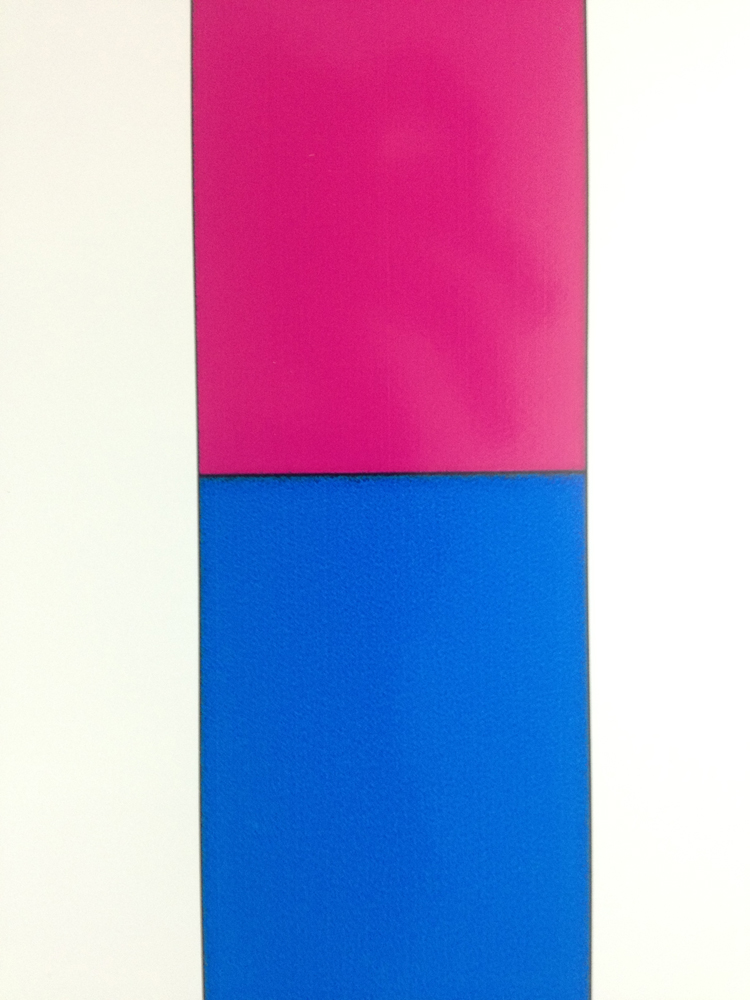

    Hi all, im having problems printing with my rs-640, im using 3rd party inks from my autorized roland dealer, my roland is printing "blurred" colors when mixing inks, i think the problem is the cyan, ive tried all, changed wipers,dampers and captops, ive changed pump lines, set the heater temp to maximum, cleaned heads with swabs, adjusted bidir, vertical and feeding settings and im still having the same problem, im posting pictures asking for your help, thanks 😀

    test print looks just about ok other prints look like poor ink poor profile or poor media. or any combination of
    check with a temp gauge that the heaters are up to the temp they say they are.

    cleaned again encoder, ive changed color managment from "density control only" to "pre-press us" and reduced cyan saturation to -4, almost all combinations of colors seems ok, im having problems only when using red with black outlines and viceversa.

    nothing wrong with the printer… just bleeding ink…
    normally caused by low-heat or misalignment but as u got a RS u have 1 head with all colours in line all the time, so i cant say it is that.
    as Chris said, more profile / heat / media sadly

    Their appears to be a lot of deflection in the nozzels in the early images. That can indicate possible problem with heads.

    Service mode prints are perfect. Look at your profiles and how clean your media is. One of your first photos, my first thought was ‘dirty’ media, looked as though their were finger smudges on it.

    I’m not a user of this particular machine, but I find with my own machine (Cadet) I get similar "blurring" of colours when printing black onto red if I print at 360dpi. Changing to a different profile and printing at 720dpi fixes the problem for me – but the print takes longer.

    Major improvement after going into bidrectional test mode, down into detailed tests
    gives 4 charts with 4 colours. Then we reset the heads which neede quite large movements and different in every colour.Tom advice at Roland
    The nozzle test show quite some deflection on the black head. Can we remove this and clear the dried ink is the next step.
