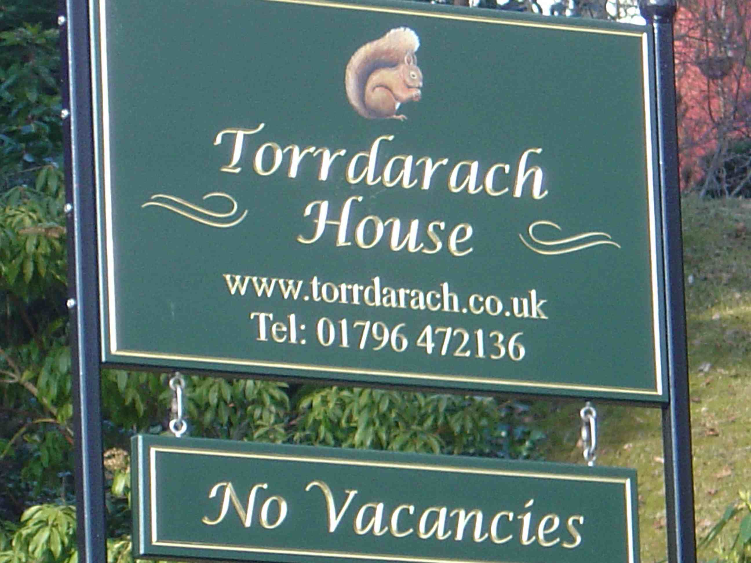

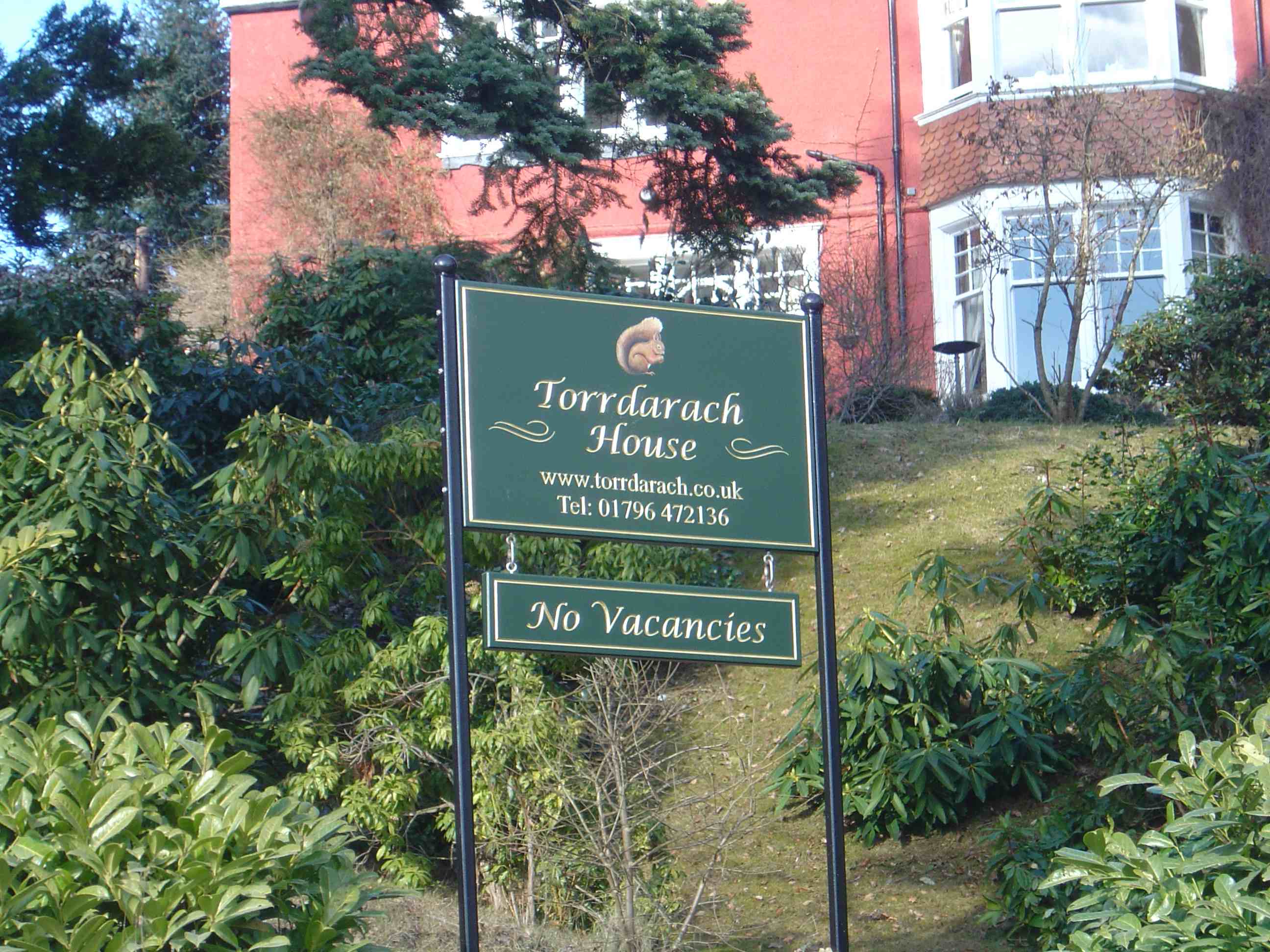

    hi folks hope you can help?.Ihave a customer is really keen on the way another hotel has there sign done and wants his to look the same .The problem is he doesnt want it to be done in wood ive emailed a few companies but i have come up with nothing to be honest. Plenty have sent me Dibond cut letters but nothing else. He has sent me these photos of the other hotel,l and to me it looks like wood. What are your thoughts im running out of ideas

    looks like steel or allly posts and mdf to me, hope it lasts..

    Am I missing somefink? Is it not just routed out of 20mm PVC or Foamex?

    It’s 20mm Foamex, v carved,
    very common around here
    We do it all the time

    hmmmm the gold is very vibrant harry although it doesnt show in the picture. Perhaps as you say it could be 20mm dark green foamx with the lettering being painted in with one shot gold or even guilded. Id rather walk away from this one if its Foamx or MDF i wouldnt use any of them for exterior work

    ian how is the letttering done is it guilded which i could do but it would be expensive or one shot

    It’s 20mm white foamex spayed green with guilded or infilled gold lettering, It’s not complicated

    ok people you are educating me here .Question ….this is buy the roadside, a very busy road how would you secure this ? I notice that the hotel in the picture has secured the foamx from the side. how is this done? the bolts wouldnt be drilled into the foamx surely. Its going to be double side so would it be better to have the poles running up the inside of the boards

    Tradesignz use 19mm foamex for their swing panels with eye hole bolts threaded in the top to swing from, if it can be used for that I’m sure would work great for that application and if I was doing a job like that I would actually feel more comfortable using Foamex over MDF.

    Yes but a swing sign isn’t going to have any problems with expansion. If you restrict the expansion by bolting it in between two posts then there is a chance distortion will occur, especially with a dark coloured background.
