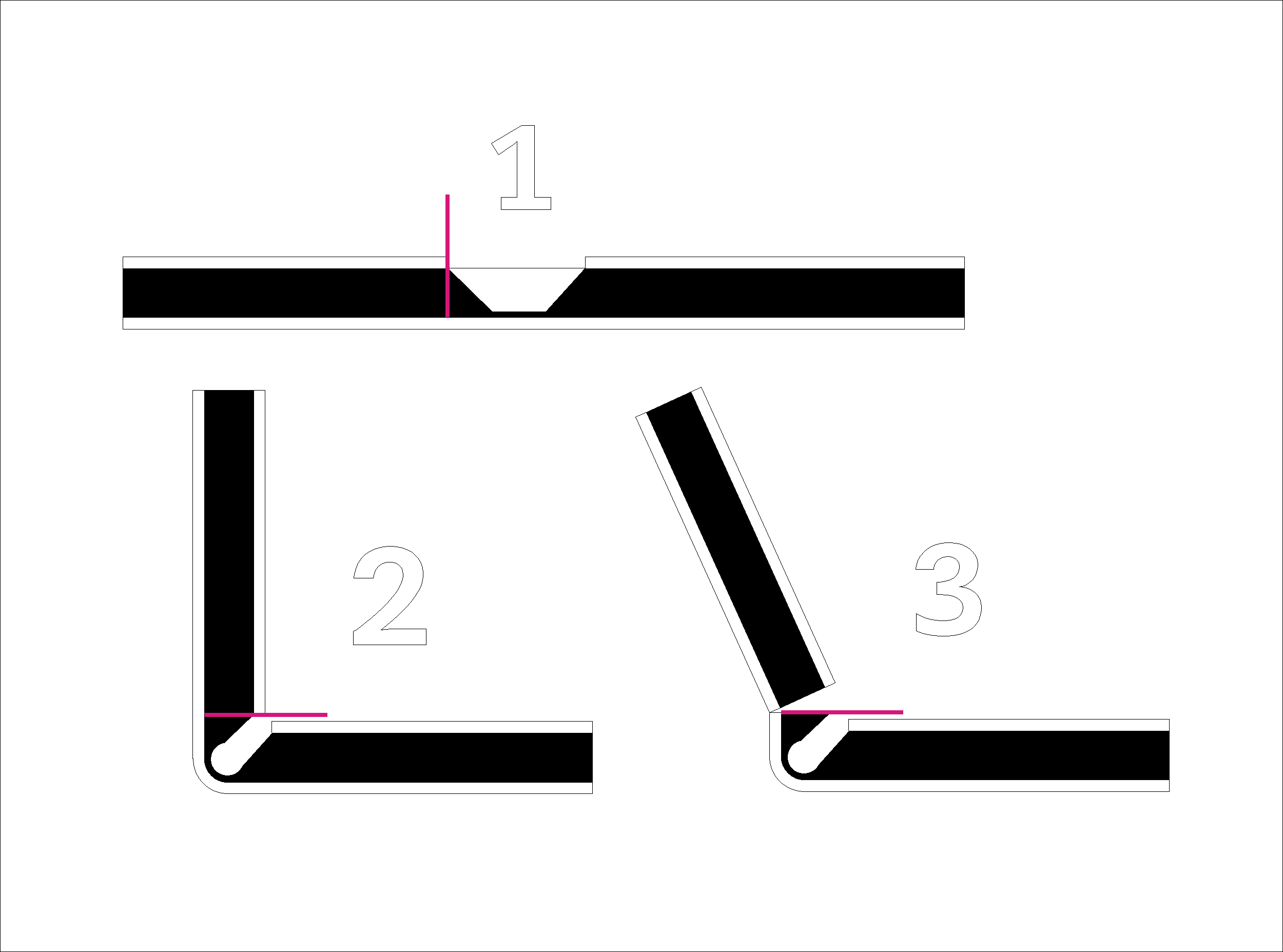

    Ideally you need a Festool pf-1200 to do this on site, well worth the investment
    leave an extra 25-30mm beyond your edge you need,
    V groove then cut with a very sharp Stanley knife along the Pink line as per the drawing, at the edge of the V cut, cut down to and score into the Aluminium but NOT THROUGH IT. Fold you folded corner and then fold backwards and the Front face of Aluminium will snap along the knife cut.
    Leaves a very tidy edge and adds £££ to the look, time consuming, but we do a lot of Bespoke ACM fascias throughout the UK & Ireland and finish them all like this,
    unfortunately all our competitors don’t so hopefully they will see this and start doing it now too 😀 they’ll soon understand why they where cheaper 😮

    That’s a nice way of doing it Ian!
    26 February 2014 at 15:46
    Yes thanks Ian – that’s a great tip, I tried this myself this morning and it works well and gives a good finish to the edge. 😀

    A router will never leave the same finish as a pf1200, because of the cutting action of the bit,
    I though the same , but used it once and seen the difference
    There are numerous reasons , a major one is the swarf is blunt and doesn’t score the face of the sheet when turning, guide wheels control the depth of the cut, never too deep , even if dropped ,

    Great example Ian thanks for that, we have been doing alot of onsite work recently , I researched the Festool had a look at it, looks like a great machine will never know till I see it in use. Currently we are doing alot of this acm folded edges onsite 4mm acm firstly setting up a straight edge to cut with a circular saw then adjusting the straight edge and setting up the router which has a v groove cutter. I know the festool comes with guild rails etc but what time would this save you onsite. Taking into account the festool just routers the panel you still have to cut your acm to size with a skill saw. What time does the festool save you in this process to justify its return on cost etc.
