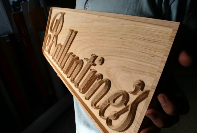

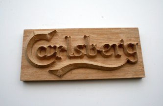

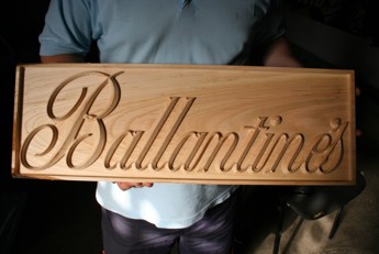

For this I used Artcam but I use Enroute3 too and a Flexicam router
nice work mate…. i like carlsberg one best 😀
are these solid pieces of Wood with the letters milled around to leave them embossed or are they routered, cut and then laid on top of these boards?
what type of wood is it?
also, i am “guessing” but you have clamped this wood as opposed to vacuum held? reason i ask is i have had no end of bother with wood moving on vacuum bed due to air channels in the woods surface etc
(HOPE THAT MAKES SENSE?) :lol1:thank you for taking the time to show us your work. 😀
these pieces are made with the letters milled around on a cherry wood and were clamped with clips.

Very interested, I use a 6mm ball nose, but my feed rate was 40mm/sec.
I don’t know very much about feeds and speeds, I have only 6 month experience.
