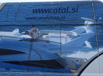

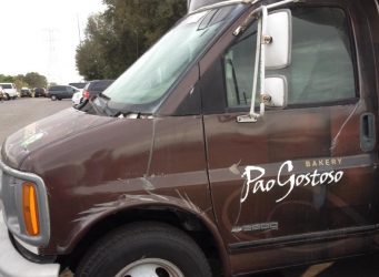

    I’ve attached two pictures showing outgassing fails. these were not mine, thankfully… but shows you what can happen when fitted to the likes of a vehicle.
    When fitted to a vehicle the vinyl is now flat to the metal bodywork, so the solvent gas cannot go back the way, so it has to come out the front. but if it has a laminate. the laminate traps the gasses. sometimes causing microbubbles. sometimes creases and so on. sometimes the vinyl just starts peeling back off because the solvent attacks the adhesive of the laminate.

    If you was the get fails as shown in the pic, whats the timescale? days, week or months
