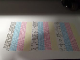

    Sorry guys, me again.
    Looking to see if someone can advise as to whats going on with my black head. When i bought the machine (second hand) the black head test prints always looked all over the place. So at the start of this year i bought a brand new head, which was fine. But the black is away as bad as ever. It only seems to be the black. Attached is what it looks like now. On the right is what the test print just came out like, and the proceding two are what its like now after doing head cleans…. its as if the black doesnt do the self clean periodically like the others.Every time i boot it up i have to go through the whole head clean thing to get the black back, and even then its not great. I have recently replaced the cap toes aswell, incase that was the issue.
    I do use non genuine inks

    Or is there any engineers in Glasgow that would come and have a look, there is clearly something wrong somewhere when this was a brand new head not so long ago šŸ˜ž
  • Kevin Mahoney
    25 August 2021 at 10:11
    A few blocked nozzles there by the looks of it Robert, has it been stood idle for any length of time? What aftermarket ink do you have in it? If the head is fairly new & not faulty, has new caps & dampers, I would be looking at the pipes for congealed ink, specifically the drain pipe from the cap which I always replaced with tigon tubing. Thats where I found solidified ink which prevents the pump from doing it’s job properly. Had my SP300 for 20 years & seen that test print a thousand times on my old versacamms. Powerful cleans will rinse your ink so if the black ink level isn’t dropping, its likely not going through the cap into the waste bottle. An overnight head soak with the cap pipe clamped off would be the first thing I’d try, power cable out to prevent it trying to do the periodic cleans when you’re not there. Aftermarket ink will normally get the blame from most engineers but I reckon that head could come back ok. A small test print every day generally keeps the ink flowing in the pipes & avoids these problems, damage usually occurs when the more aggressive solvents sit in the machine not moving.

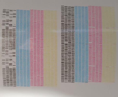

    25 August 2021 at 21:51
    Well done a head soak for many hours today, checked all the pipes, just put it back together there, ran 2 meduim cleans and pic on right is the result. Done a 3rd medium clean and pic on the left is the result….. black dropping out again…. so so frustrating.

    25 August 2021 at 22:46
    Well the right picture indicates that most nozzles are firing & not much deflection is present so the head itself looks in good order. Did you change the manifold on the head? Were the dampers changed? Is the cap seating properly? Not familiar with lotus ink so won’t make any judgement on the ink. I ran Nazdar in my Rolands & had very few issues, & all wet parts were warranted so some support was there to fix any problems I had. If you still can’t solve, I’d call Andy Malcolm from ADM services. The bloke is as straight as an arrow & knows Rolands like the back of his hand, he may even sort over the phone if you send him some photos

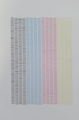

    10 September 2021 at 15:55
    Hi Guys…. just a wee update if anyone is interested…. the attached image is where my print test is now after changing hoses, manifold and several nights head soaks. Far better than what it was from the original test print šŸ˜€, thanks for all your help.

    • Kevin Mahoney
      10 September 2021 at 16:56
      That’ll be Ā£650 pounds please
      • Robert Neill
        10 September 2021 at 17:04
        Bargain…. i was almost purchasing another new head lol. Just need to get shot of the slight banding now… i am such a perfectionist, so its killing me 😩

  • John Thomson
    11 September 2021 at 10:24
    Looking much better now.
    Banding is now probably down to head alignment.
