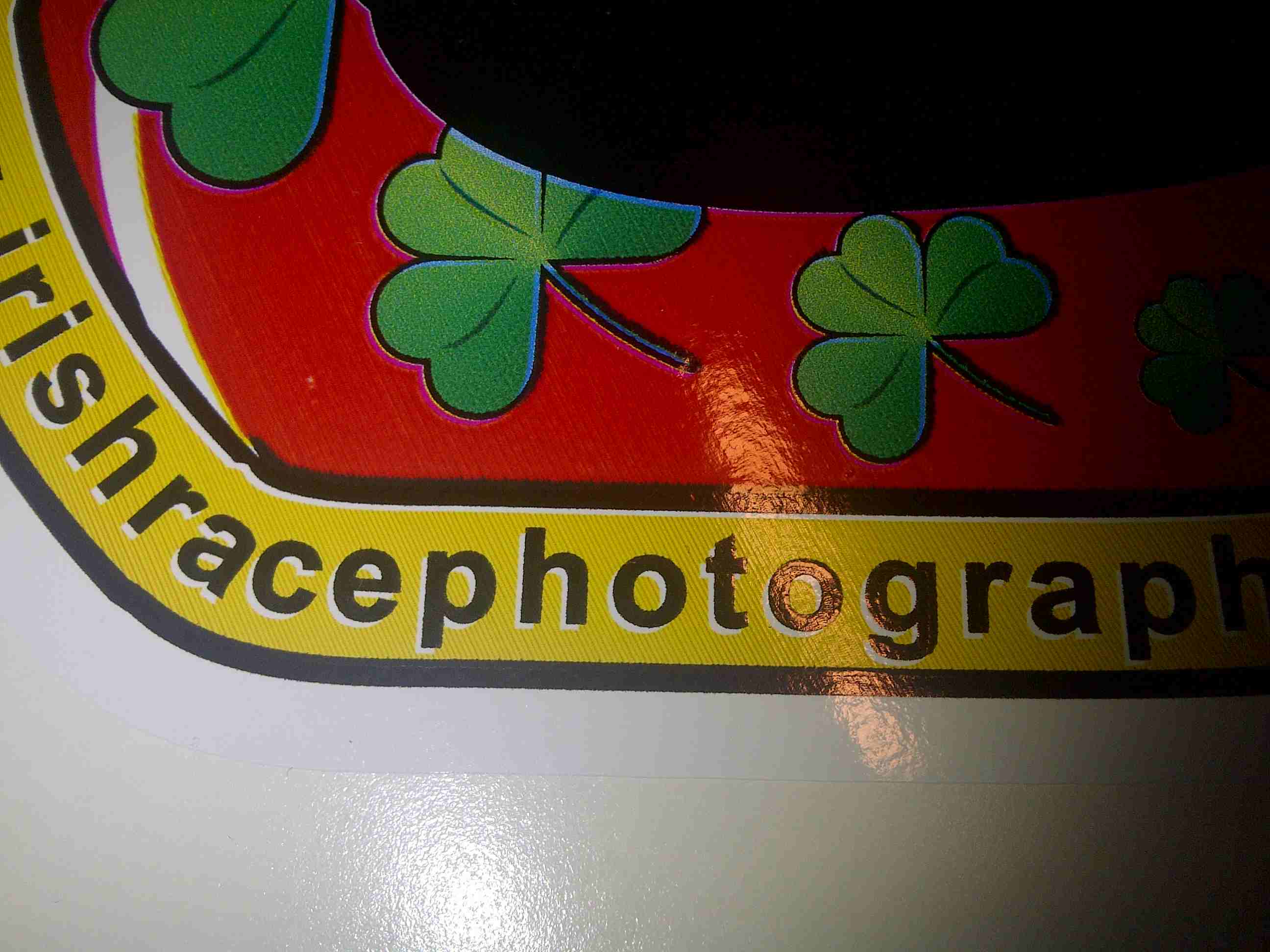

    Hi All, was hoping someone could advise me as to what my problem might be.
    if you look at the attached image there is a white line around the black, blue around the green etc
    any help would be great
    Craig
    roland soljet 500

    The black head has likely had a knock and it’s been whacked out of position at a guess as not familiar with this printer.
    Run a set of head alignment tests to be sure.

    yellow too…
    quite a few out of alignment.
    headstrikes are the likely cause but thats a big strike

    what is the gap mm. and how many heads if 2x heads is yellow and mag together.
    also is the deformed black bit on the left correct

    What rip are you using? I experienced similar problems and solved it with 2 things…. a full maintenence clean on the heads using cleaning fluid etc (took me a good hour or so to do it properly) wipers, capping stations etc etc (the dragging on the edge of the black gives that away) and also I had my rip profile set to max impact which always messed with the colours especially the whites.
    BUT!
    2 things more, can you post a copy of the eps file so i can have a test to see if there is something in the file that may be awry and……. what happens on a test print? Full test print and normal nozzle check print? if you could post those here too that may give a better indication
