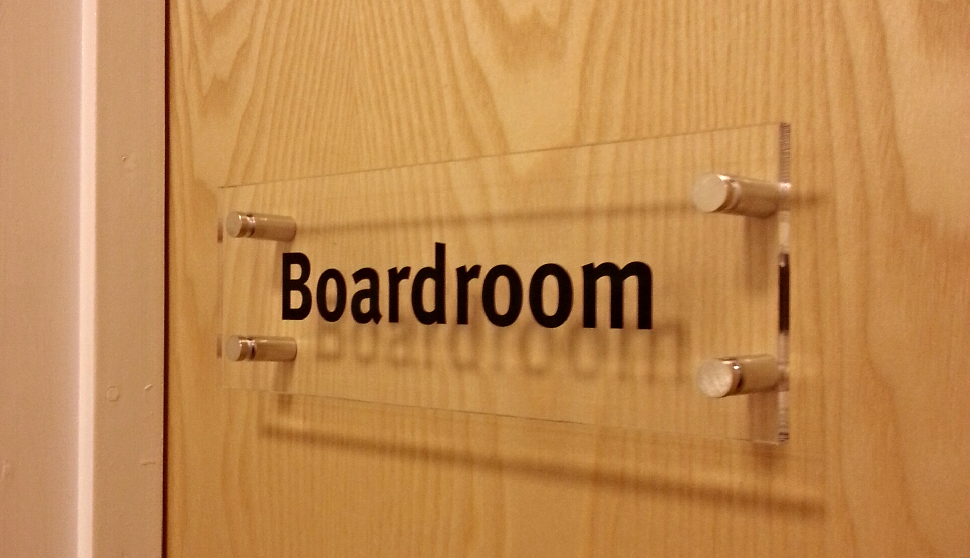

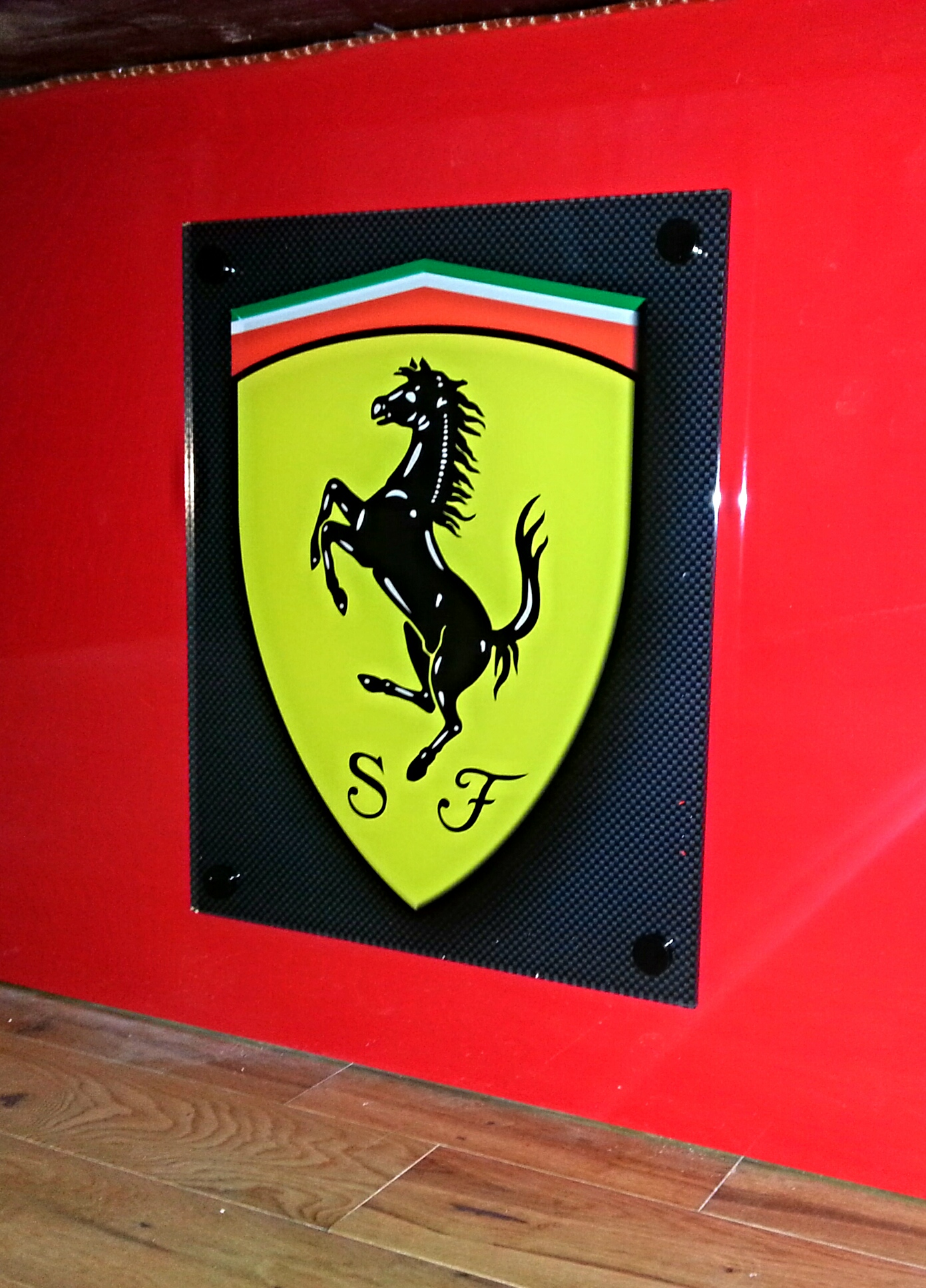

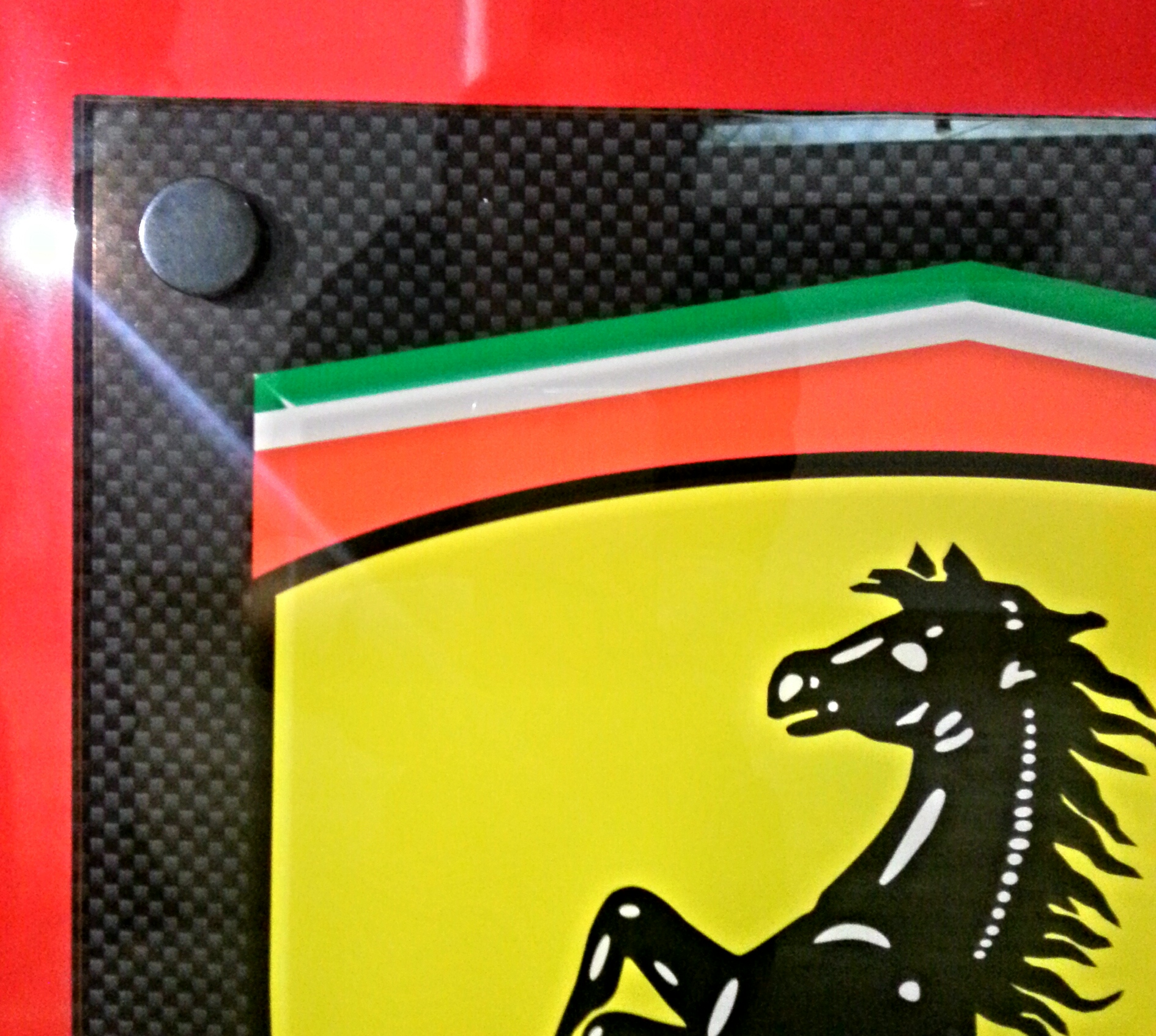

How did you get the carbon look on the reverse acrylic sign?
Just apply carbon vinyl to the back? Looks like a smooth finish, I would have thought the texture would have been an issue.
quote David Hammond:Nice work.
It’s all reverse printed on clear then backed off in white (then applied to the back of 10mm acrylic with flame polished edges) – photoshop carbon effect or even just get a pre-done texture from a free site.
quote David Hammond:Brilliant result!
What clear vinyl do you use?
Actually print laminate…then ‘laminate’ it with print white.
Do loads of reverse plaques, reverse printed windows etc. Works great.
